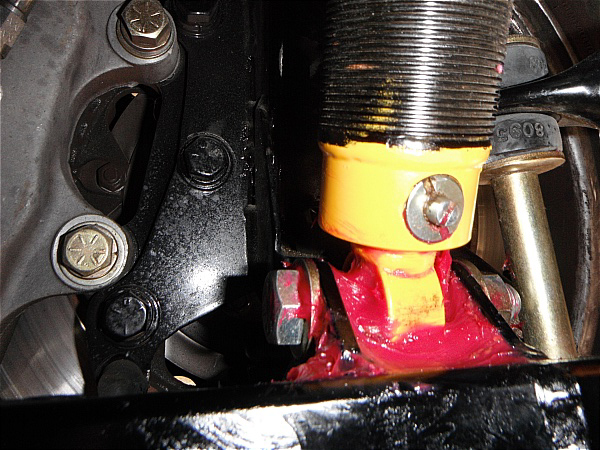

As requested, here is a pic of what we're talking about (the lower spherical bearing of the front shock mount and how I "pack" it). This technique is actually recommended by SKF. And Jaydee likes to rib me that I have a heavy hand with grease anyway.

Why not just drill and tap in an zerk fitting if you are that concerned? Or, just use a turkey injector?
Old 02-28-2016, 02:54 PM
Posts: 22,025
Bob says he's only seen a couple of problems in hundreds of cars. But, SKF recommends packing grease both in, and around, the bearing to essentially "seal it off" from the elements if the bearing is exposed to particularly rough conditions (which it isn't). Now you gotta admit, that's a nice looking grease packing job.
Another methodical and time consuming mess by Patrick!
