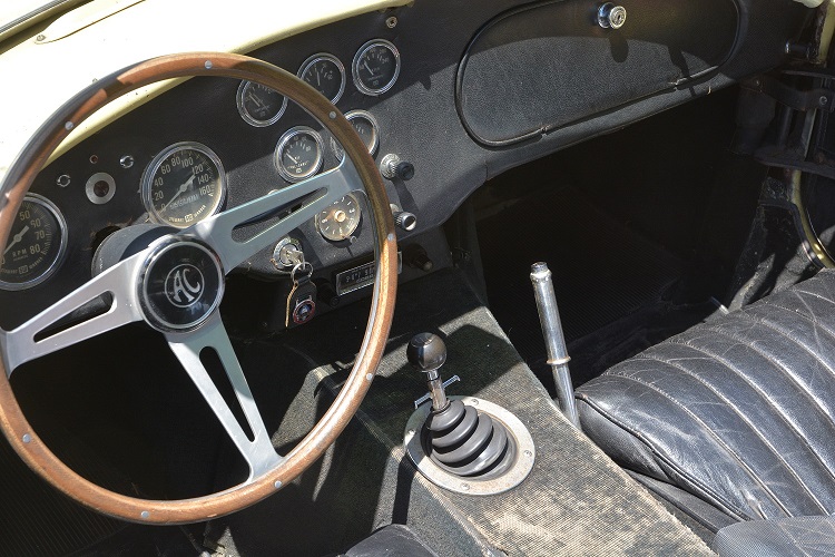

That now leaves the Transmission. Would like to go BW T10/ Toploader (Long tail/short tail?) for Period correctness, but a Tremec TKO 500/600 is also a great choice.
Does anyone know, which unit will give me the correct shift stick position in the cockpit?
Any ideas?
