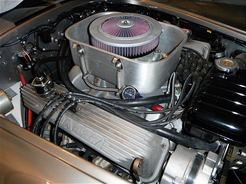

Thanks. It's a 445 stroker with BBM heads and one of Brent Lykins' roller cams as well as his rocker arm setup. The block is a 391 with crossbolted mains added as well as screw-in freeze plugs.

Great looking project. Looks like you have plenty of flow in the air cleaner. May I ask how much clearance to the hood? I am building a street version with ford fe, no scoop. And loosing a little sleep wondering what my air filter options are.

This might help you start to come up with a plan. My hood has a scoop, and I have a TP as well, but here is a shot with a K & N 9" round filter with the Xtreme Top. The total height gain is only one quarter inch. The second shot is through the scoop with a 3/4" roll of black electrical tape sitting on the top. The roll of tape just barely touches with the hood latched. This should start to give you an idea of what you'll have under there without a scoop and without a turkey pan between the carb and manifold.

The early Camero/Corvette 14" drop base is the lowest profile air filter I know and it is relieved to clear a Holley carburetor. You can use the 14" top of your choice and 14" air filters are available in many heights so you can pick the biggest one that fits your car.
