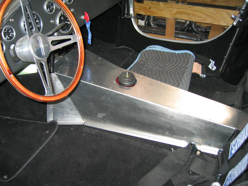

It's looking awfully tight there on my Kirkham for a Tri-Ax install. I would love to get one, but I get hives just thinking about removing the tunnel and re-riveting.
You're right. No chance of accessing it from the top and removing the rivets would be a pain.

If there's ever a circumstance where my tunnel has to come out (e.g., when the SOHC gets dropped in ), then I'll get the Tri-Ax.
