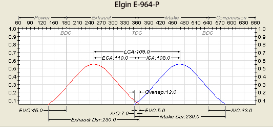

I still think that cam is too mild for what he wants. This is the Elgin E-964-P as the engine builder installed it:
That is a pretty mild cam, but I would still think he could get the car running well enough to not have a tuning bog. Gunner, did you get a dyno sheet on this motor? What kind of power did the PO say is it supposed to make?
I'm not looking for a fire-breather. If I can get another 10% over the original dyno pull (440/475), I'll take it. Joe Lapine was of the opinion that at least that much was in a good dyno-tune. I'm looking for all that power in a tractable package with no surprises. Relatively low maintenance and no sharp breakage points are plusses, meaning a hydraulic cam.
