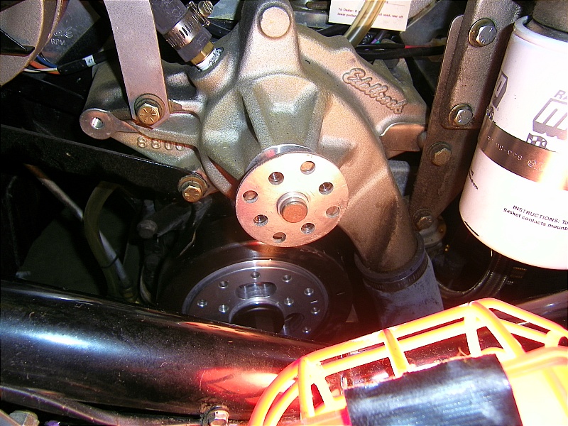

It will end up looking similar to mine. Note that you may have to do some grinding on the boss on the water pump to get a plumb fit.

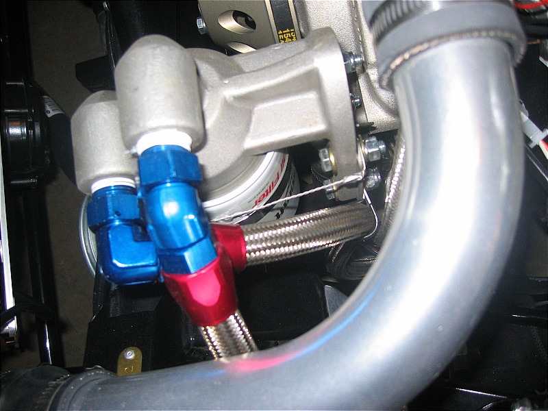

Here's a shot looking down on the remote filter. Yes, I safety wire my oil filter.

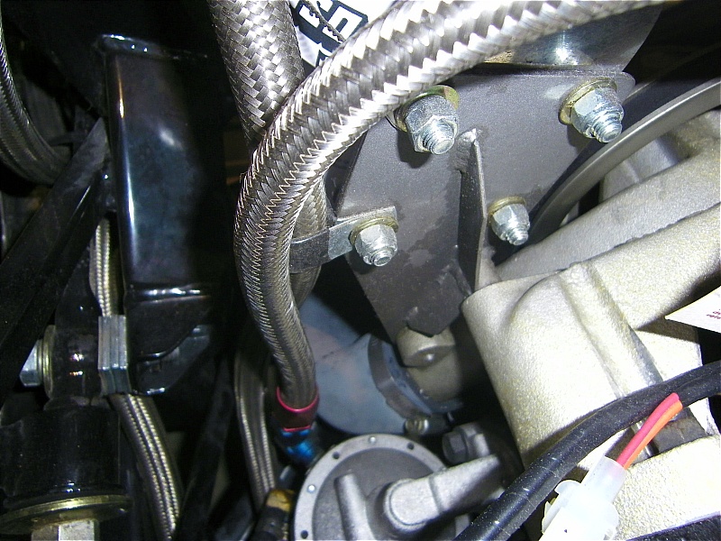

Look at that black bracket pic I posted. Lower two holes bolt to two driver side bolts on WP. The upper 4 mount to the filter adapter.

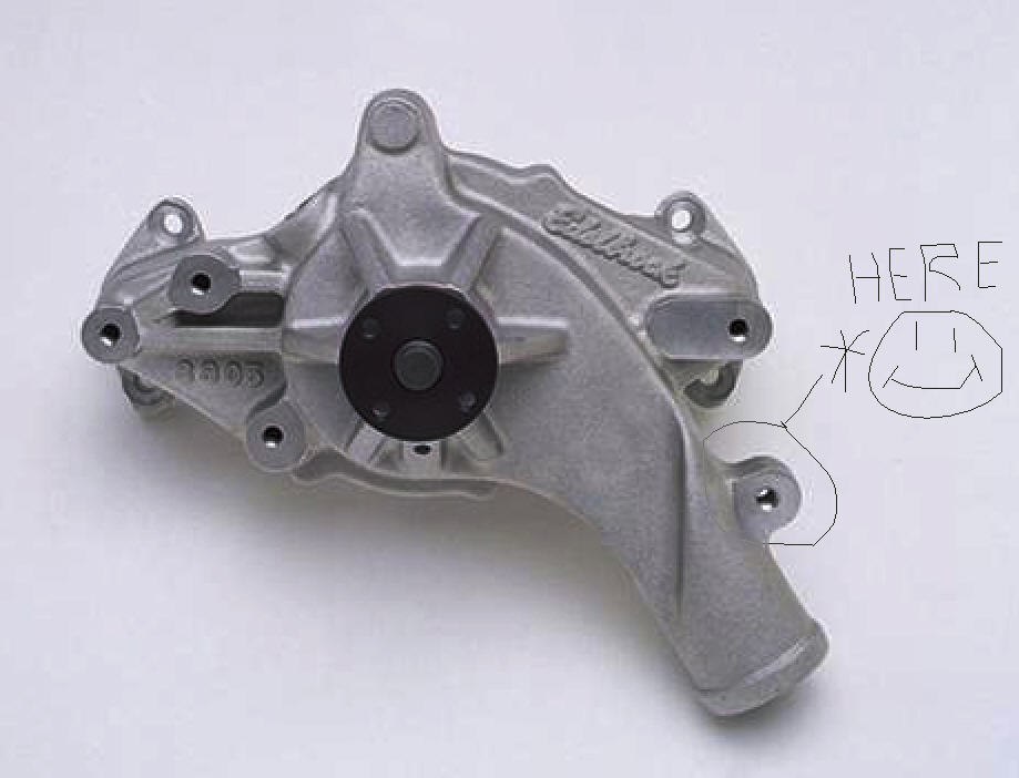

Grind Here
... the lower boss on the inlet tube, that is.

Part 2:

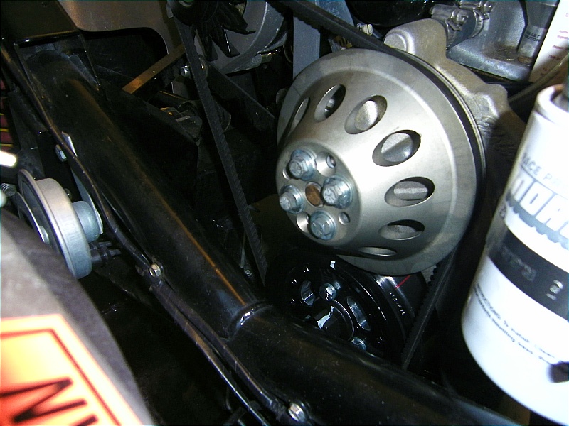

How close does your pulley come to the bracket and filter ?

I used the billet adapter block from Southern Automotive and ran the oil lines up to your pictured filter mount like the original cars. Now the filter is up to where it won't get damaged from road debris and its clean and easy to change. Much better setup in my opinion.

I love technical drawings ..."Here" !
