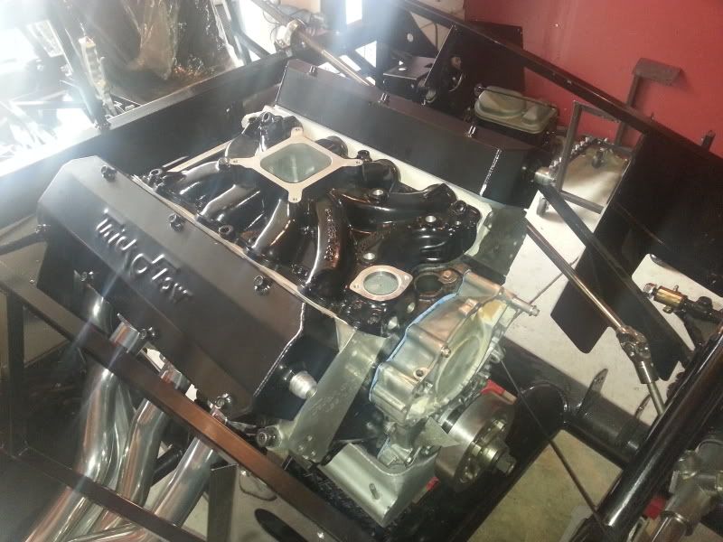

Originally Posted by Herman1 View Post
Does anyone now if I will have much trouble changing from a 390 FE to a 460? Also is there any suggestions? Thanks
Here is a pic of mine:
I'm about four months into my build. I switched to the Torker II intake(as previously stated) and had to change the oil pan too. Other than that, steady as she goes.
Good luck, let me know if you need anything.
