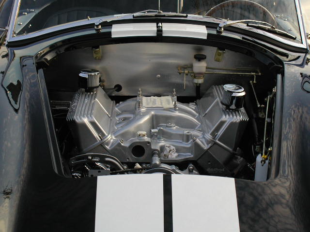

Nantucket,
See my gallery for pictures of motor. It is a 428, has edelbrock aluminum heads, intake, waterpump, Aviaid pan, etc, most of which is powder coated silver with a clear coat. Cam is a comp cams solid lifter. Rocker setup is Erson. Heads have had a stage 1 port job. Oil pump by Precision Pumps. Will have MSD ignition and Holley 750 carb, yet to be installed. Has aluminum flywheel and a blowproof bellhousing. Rotating assembly was all balanced. Ie, should have plenty of power!

Nantucket,
The Performer RPM has an embossment behind the carburetor to put a PCV in. I drilled a hole in that embossment the same size as the one in the valve covers and am going to use a regular valve cover grommet and PCV in that back manifold location. Right now, there's just a piece of masking tape covering the hole until I hook all of that up. I've seen different things done, including putting a breather in that location. I thought this would look cleaner because the hose from the PCV would just come up to the back of my carb instead of laying across one of the valve covers.

Old 04-19-2004, 06:00 PM
Join Date: Dec 2003
Location: Small Town, IN
Cobra Make, Engine: Kirkham, Pond Aluminum 482FE
Posts: 349
Update 4/19/04: Car is finished (actually, got it driveable about 10 days ago)! Here is a picture of the engine. More in my gallery....
