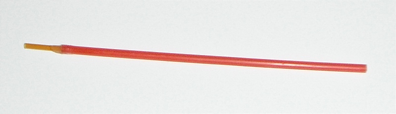

The main bleeds, as opposed to the idle bleeds, are smaller in diameter, so I have special "thin" straws that fit inside the regular carb cleaner straw so it doesn't blast back up in to your face. It fits down in to the main air bleeds, nice and tight, just like the fat straw does in the idle bleeds. I would post a pic of them, but ol' Chas might get his nose out of joint.... Tell him once again how crappy your car was running before cleaning them, and how great it's running now, and how wonderful you think I am....

Pictures of straws. Plus excruciating detail on their proper use. The drama and tension are getting unbearable...........

I did ask him specifically how he did it, and he just answered the question with some detail.

Yeah Chas. A detailed, explanatory text coupled with an enlightening pic. I am afraid you're just a cranky ol' butt.
