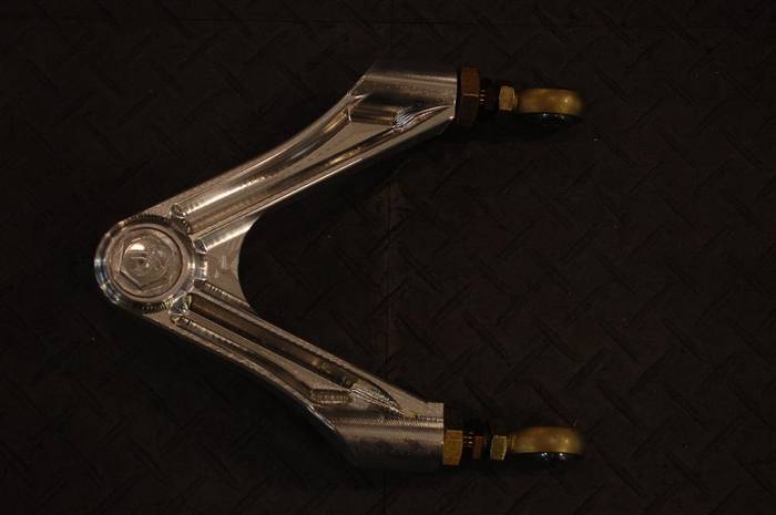

Front upper control arm update:
This is the first, prototype, front upper control arm out of the mill--(lots of chatter; we'll fix that with the feeds and speeds on the production parts). Notice we now mill "L" (and "R") with an arrow pointing forward in our front upper control arms.

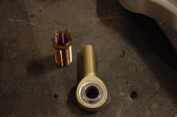

we made some really cool sleeve nuts for the control arms (page 135).
We decided it was time to upgrade all Kirkhams to the billet chassis sleeve nuts. We got the idea from a Riley and Scott Lemans chassis. The nuts are brilliant because you don't have to unbolt the control arm to adjust camber, caster, or king pin angle (if you are so inclined). The sleeve nut is right hand thread on the outside and left hand thread on the inside. Just loosen the jam nuts, twist the sleeve nut, and tighten the jam nuts. They save a TON of time aligning the car--and are more precise.

Love the adjustments on the LCA's. That's genius.

On those sleeve nuts, did you fabricate those or find them aftermarket?
David Kirkham 06-17-2011 11:18 AM
Originally Posted by dallas_ (Post 1135228)
David,
We make them from 17-4 PH (same material as our hubs, sway bars, ball pins, and anything else we don't want to break) and heat treat them (H900) in house.
