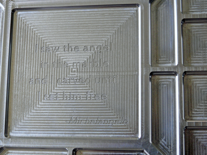

Here are some pics of the parts as they came out of the mills.
