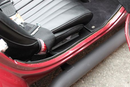

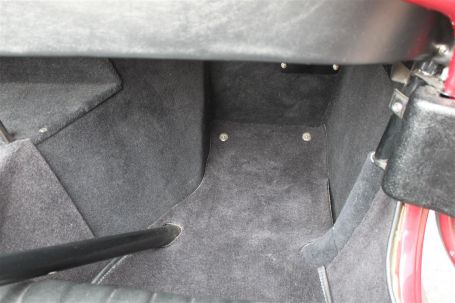

After searching around a bit I found an example of Lift-a-Dot fasteners holding the floor mats in place on CSX3004.
It also shows two fasteners in front on the passenger side. I hope this is helpful and clears things up at bit, although we all know that there is no one right way.

Old 08-27-2012, 04:45 PM
mickmate's Avatar
Join Date: Sep 2000
Posts: 5,499
Great shots Bob thanks.

Old 08-28-2012, 07:11 PM
mickmate's Avatar
Join Date: Sep 2000
Posts: 5,499
I guess this good shot answers that question. If we look at the underside of foot boxes we will find out if they used self tappers or nut type studs.
