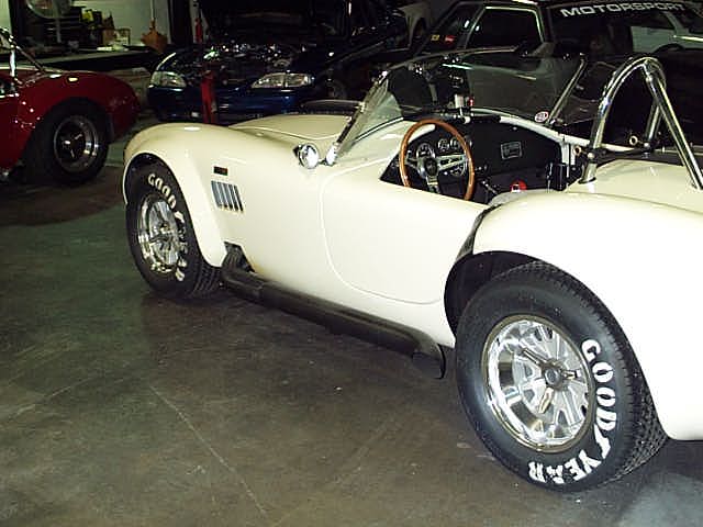

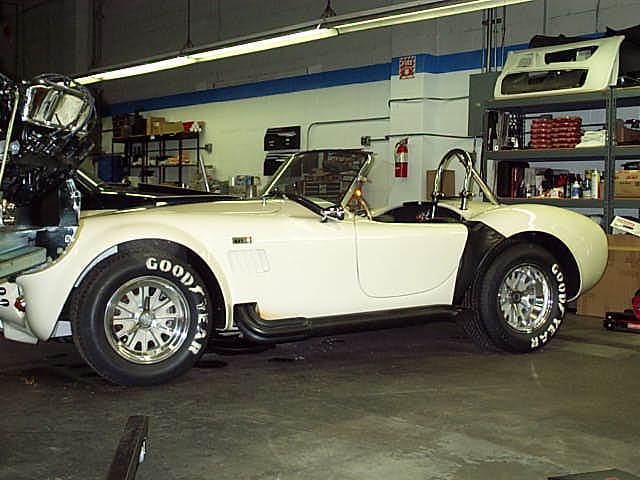

Here you go.. Sorry for the not so great pics, my camera is like 5 years old and the shop lighting sucks...

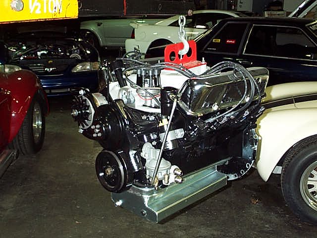

And one pic of the mighty FE, just because...

Thanks for the pics! I'll definately run that way. I may try to come up with a different inverted dust cover for the front to protect but give the no cap look all the way around.
By the way, I like how you removed the paint on the Eagle part of the tires. If/when I get a set of those tires I'll likely do the same. Oh, and you just had to make people dool with the FE shot, right?

Hehe, yeah. I spent a LOT of time and effort on that motor, making sure every nut, every bolt, every wire, bracket, clamp, etc was as correct to an original as I could. Lots of photos, questions, and buying wrong parts . But I am really happy with how it came out. Other than the obvious block difference (it's a 390), the rest of the motor is pretty much exact to an original (save for one or two items I haven't changed yet).
