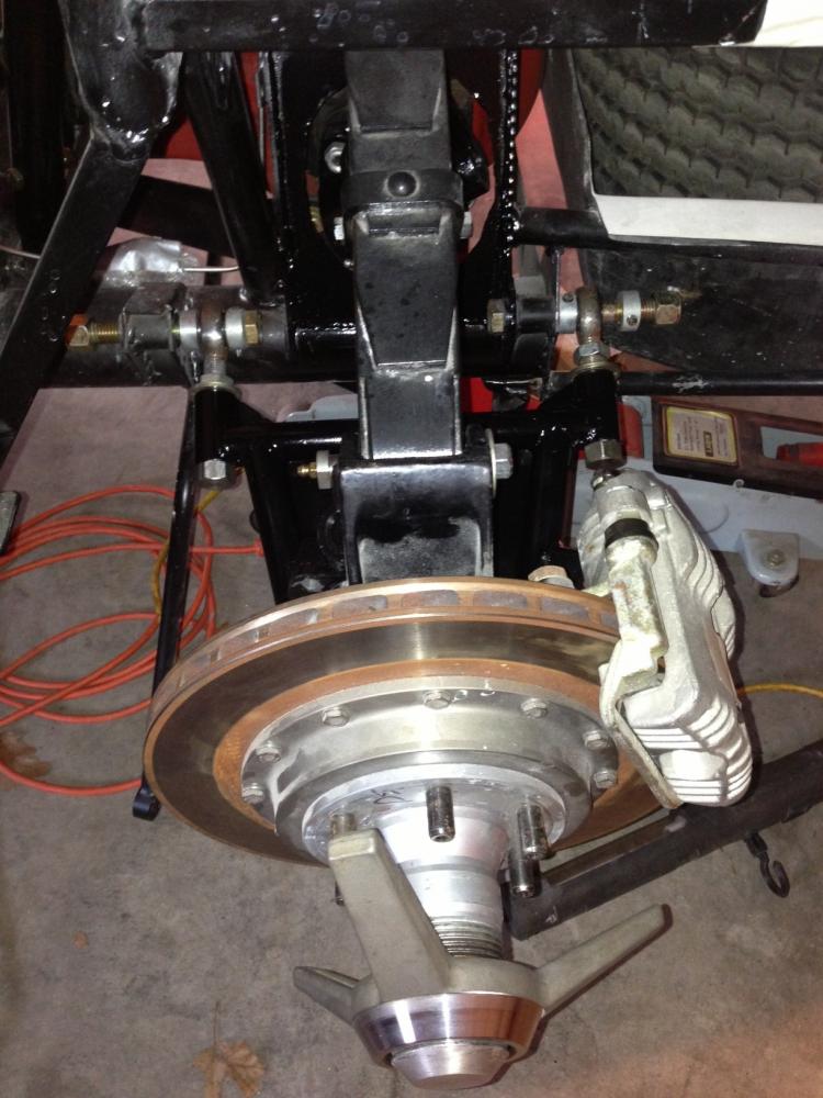

Fitting................. :rolleyes:
Needed to get a bit more length on the lower A-arm as I am running big tires versus the thin wire wheel type. A-arm work was a success and now fully adjustable with big tires....
http://www.clubcobra.com/forums/pict...pictureid=9885
