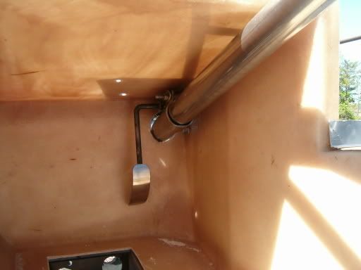

Old 04-30-2006, 11:58 AM
KarlCSX2498's Avatar
Join Date: Aug 2004
Location: Near Phila. (Collegeville), PA
Cobra Make, Engine: CSX2498 has been in our family garage since '68....Scratch built aluminum bodied 427SC Cobra, 427FE, CSX3000 chassis specs, 95% finished, only needs paint.
Posts: 642
Default PHOTOS of FLaming River Steering Column Installed

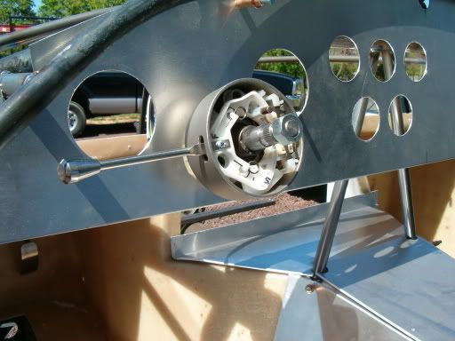

Old 04-30-2006, 11:59 AM
Join Date: Aug 2004
Posts: 642
Default Another photo of Flaming River steering column

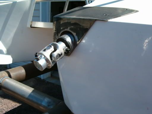

Old 04-30-2006, 12:02 PM
Join Date: Aug 2004
Posts: 642
Default another photo flaming river steering column

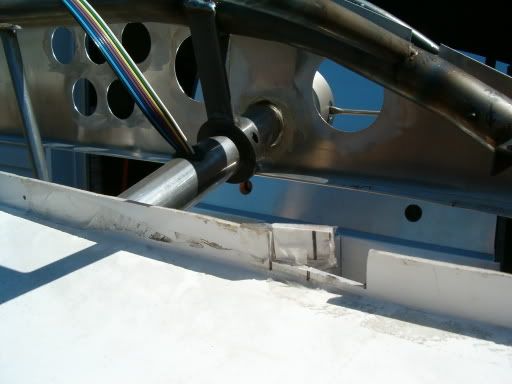

Old 04-30-2006, 12:04 PM
Join Date: Aug 2004
Posts: 642
Default last photo flaming river steering column
