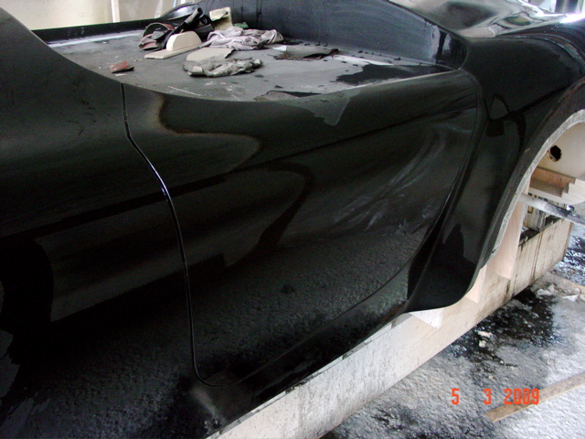

more or less, finished buck !
as it was 2 months ago

That is AMAZING! Are the strips plywood? How important was it to get all the surfaces "rounded" so to speak? Did you use "filler"?

yes strips are made from plywood (20mm thickness)
sanding and little filler used for preparation of body

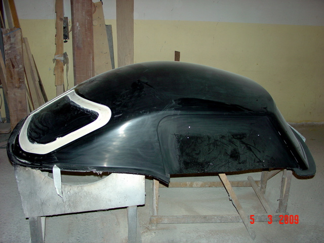

Hi to all,
Here it's, final shape of hardtop's rear glass.
Regards,
Ozgur @ istanbul

Beautiful work as always Ozgur!
Keep it coming

Beautiful Ozgur! Now I wait in anticipation of seeing it mocked up in place on the buck. Post some side profile shots too, if you can. This documentation of your work in this thread is inspiring.

Hey Buzz,
As requested, side view of hardtop
