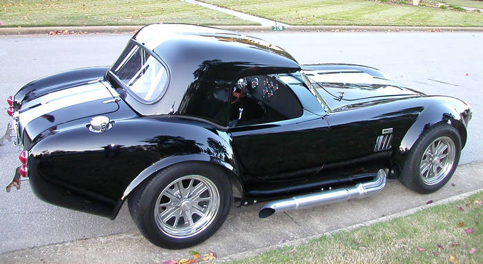

Old 09-26-2007, 03:04 PM
Tony Ripepi's Avatar
Join Date: Jun 1999
Location: Dublin, CA
Cobra Make, Engine: TBD
Posts: 1,298
Here is one picture from the ERA site with the angle indicated....
Tony R
Old 09-26-2007, 04:01 PM
mickmate's Avatar
Join Date: Sep 2000
Posts: 5,499
It should be pretty close, just note that's the 289 body (beautiful ain't it?)!!
