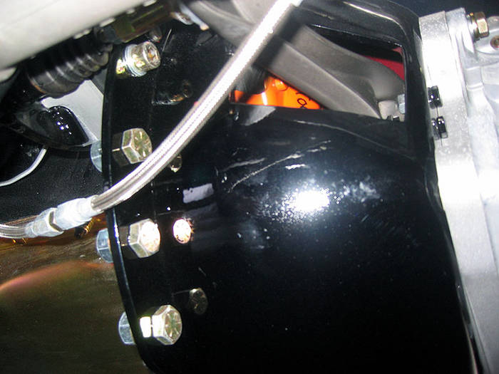

Here is a shot of my TKO/Lakewood/FE that illustrates what Brent is talking about.
