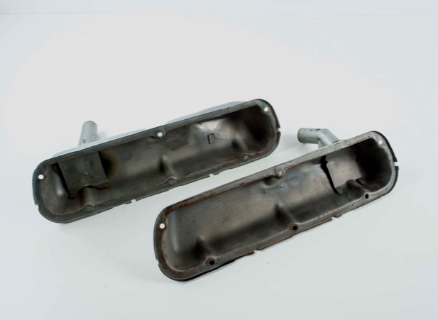

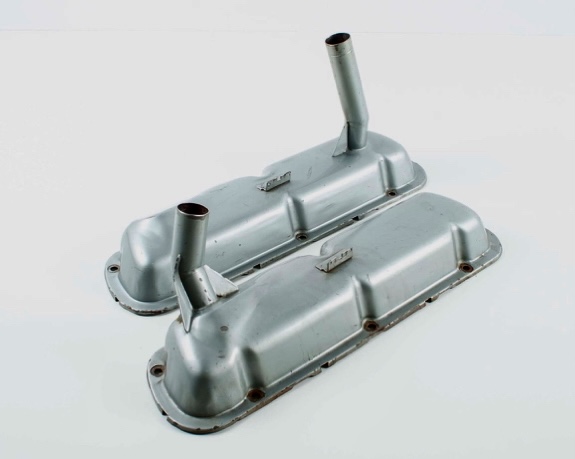

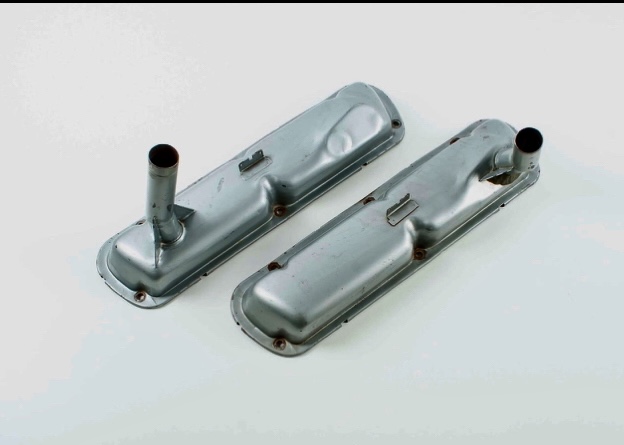

the "real " ones were made from the early 260-289 valve covers, didn't have the flat spot where the breather is, the early motors were oiled thu the intake manifold, later engines thu the breather, depends on how 'real" you want to get. I got a set of the early rocker covers, but thems going on my car, the $500 is a good price if you ask me
289 FIA Valve Covers - Club Cobra Photo Gallery
Old 04-03-2022, 08:18 AM
LMH's Avatar
LMH LMH is offline
Join Date: Apr 2005
Location: Tucson, AZ
On original covers, there were a series of baffles brazed in the breather tubes. The tube was then brazed onto the cover.

The tube diameter would be the same as standard Ford tubes using push-on breathers. Not sure off hand what that is but I can measure it on my covers when I’m home. Angles could figured by mocking the tubes up in cardboard on covers mounted on an engine. Same with the braces. The GT350 style breather setup you’re looking at had a baffle inside the cover.

So the breather tube on an original Cobra valve cover measures 1-3/8" OD with a wall thickness of .065". I see McMaster-Carr sells 4130 in that size, stock # 89955K129.
I also found a couple pics online similar to what you were looking at. These are original GT350R covers modified by SA. Note the baffle inside the covers.
Alba gu brąth
