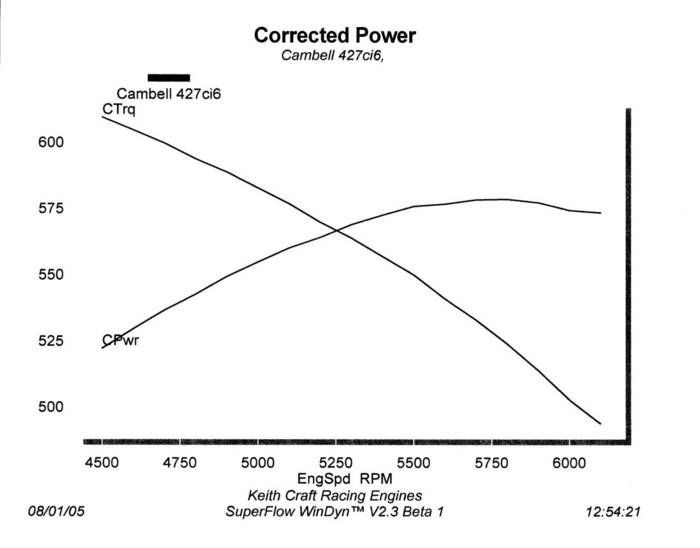

AFR 205 heads, Performer RPM Dual Plane intake (due to clearance for the coupe), KC custom grind Comp Cam. About 12k miles so far. Dyno results below...

Wow! Look at that Power and Torque. Surprised it runs like that with the RPM intake.
Was the manifold ported and what size carb? Is this a 4.125 Dart block?

I do have a question on your dyno graph. Why is the engine going so lean at the top of the run?

Using a Holley 750HP with no choke. Not sure why it is lean at the top of the run - would have to ask Keith on that one as I am not an engine guy by any stretch... Keep in mind also that it has to run on crappy CA 91 octane and is used as a "frequent" but not daily driver. The 12k miles was put on in about 2 1/5 years. I did have it dyno tuned with the coupe exhaust and everything once I had it together and at my altitude, etc. they did re-jet it as it was running lean. It is a Dart iron block with four bolt main. I wanted something fairly indestructible.

Thanks for the info! I remember that Richard Holdener,built a 410 Dart type engine,for the 2004 Engine Master's Challenge event,and also made big torque and power using the RPM AirGap intake. It was really ported out though and mounted a big Dominator carb.

Do you have the in car dyno results? That would make for a nice comparison for h.p. loss from flywheel to rear wheels. Curious why you posted this after 4 years but glad you have good results.

Just posting because Keith still cares about customers four years later - long after he has collected their money. It's a rare thing these days... If memory serves, the rear wheel hp was 437. Keep in mind the coupe has IRS which causes a little more loss, plus not sure what fuel Keith was running on the engine dyno pull. The chassis dyno was using CA 91 octane...
