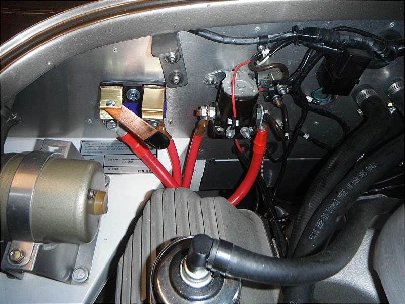

A member requested a pic of my disconnect. It's a Battery Doctor knife switch rated at 250 amps continuous and 750 amps surge. I like a knife switch because it's easy to tell whether it's on or off.
