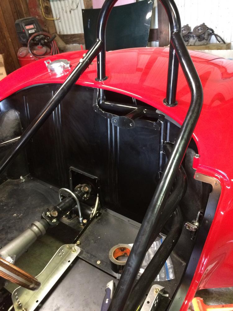

Got a couple of things accomplished today. Spent a couple of hours with the tin snips cutting the rear panel to accommodate the changes due to the roll cage additions.

Then I figured, well, if you are going to be able to test start the car soon, it would be nice to have a seat installed.....so
Will be working more on the throttle cable and finishing some small things off, in addition to installing the passenger seat and transmission tunnel over the next couple of days.
