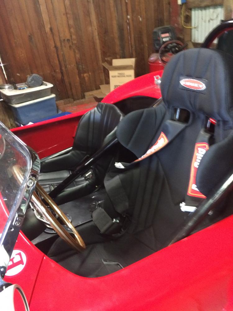

Then I figured, well, if you are going to be able to test start the car soon, it would be nice to have a seat installed.....so
http://www.clubcobra.com/forums/pict...=16840&thumb=1

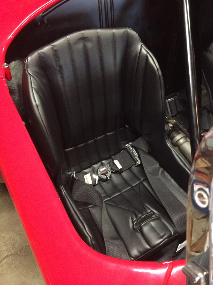

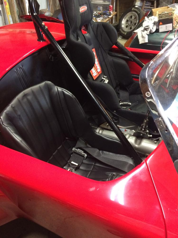

I then moved onto installing the passenger seat. While I could run without a passenger seat, it was common during the time that these cars were raced to have a passenger seat. In addition, if you run without a passenger seat you have a 25lb weight penalty that you have to add to the car. It was a little easier than the drivers seat, in that I did not have as much roll cage to deal with and it is a smaller seat. I like the looks of the seat and thought about using it for the driver, but I need more protection and the vintage rules would have required me to infall a padded head support as there is none on the passenger seat.
http://www.clubcobra.com/forums/pict...=16856&thumb=1 http://www.clubcobra.com/forums/pict...=16857&thumb=1

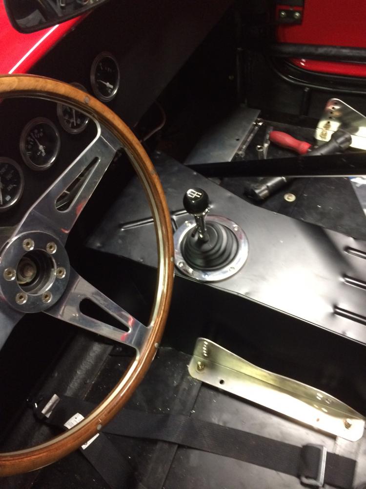

It looked great, then it was time to install the transmission tunnel. Unfortunately, you have to remove the seats in order to install the tunnel ! :eek: So, out they came. One might say, well why did't you install the tunnel first? The reason is that with the race seats my mounting points and support were different than the stock mounting and I had to make sure that the seats fit. I could always adjust the tunnel (which it needed a lot of cutting) but was limited in how I could adjust the seat mounting.
After numerous progressive adjustments to the tunnel cover, it was finally in place and the shifter worked in all gears without binding. :D
http://www.clubcobra.com/forums/pict...=16858&thumb=1 http://www.clubcobra.com/forums/pict...=16859&thumb=1

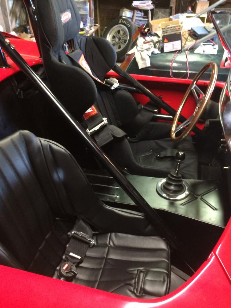

1795 07-26-2017 05:28 PM
Todays work
Had a fairly productive day today. Re-intalled the seats and finished up the interior.
http://www.clubcobra.com/forums/pict...=16867&thumb=1 http://www.clubcobra.com/forums/pict...=16868&thumb=1
