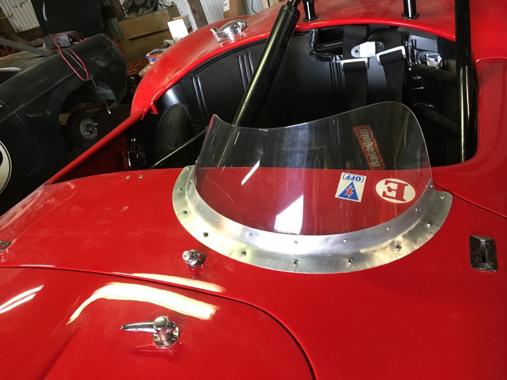

Today my new race screen arrived. Thanks Rick and Time Machines!!! I could not wait to get started, so I went about removing the windshield by myself, not something that I would recommend. Luckily I already had the seats and steering wheel removed so that saved a lot of time and frustration. Even with those items out of the way, it still took me about 3 hours to remove the windshield. All of the retaining bolts are hidden underneath the dash or tight places. You spend the majority of your time on your back underneath the dash trying to figure out how you are going to access unto that are barely visible at times, one was completely hidden by a relay switch. By the way, again please excuse the orientation of the pictures, it again turned them, so I went back to my photo album and rotated the pictures thinking that it would them turn them the right way, and it did not. I will have to figure this out later.
http://www.clubcobra.com/forums/pict...=17510&thumb=1
After you remove all of the bolts the fun begins. I figured that the windshield would just slide out of the slots and I would carry it away with no problem. Wrong! I should have expected it, and quickly realized what the problem was when the windshield did not want to move. Invest in RTV, Superformance uses it wherever they think there might be a potential leak. The bast@@@# was glued in place. Spent about 30 minutes prying and puling before it finally broke free, then it came out pretty easy.
http://www.clubcobra.com/forums/pict...=17514&thumb=1

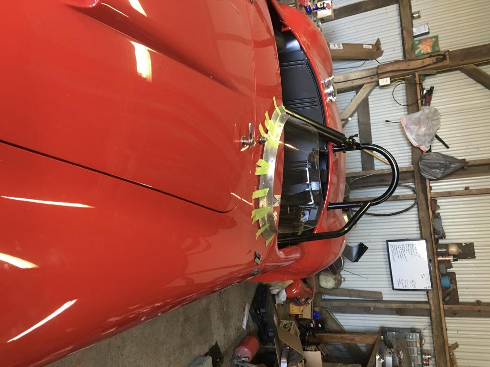

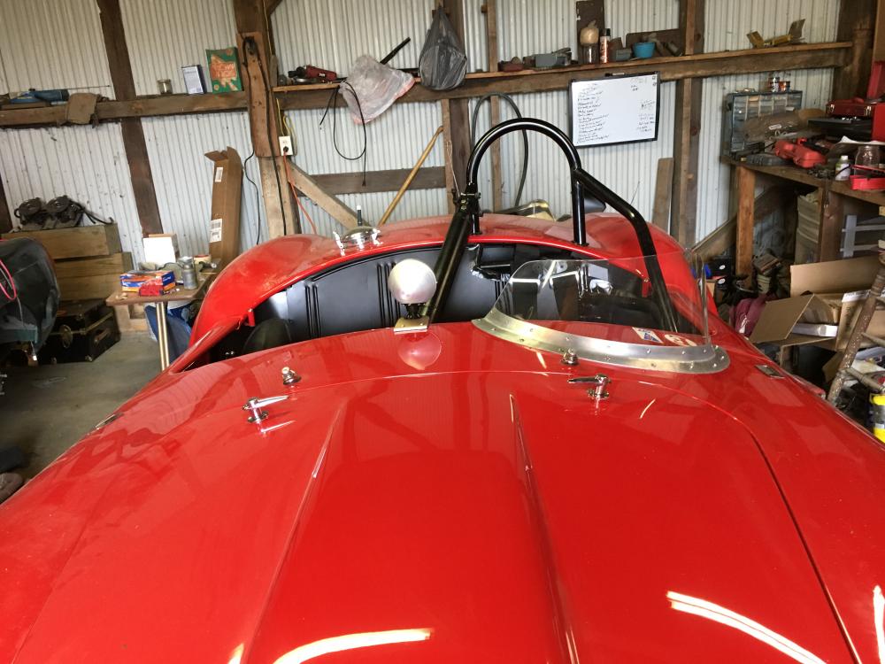

I then did a rough fit of the race screen and that is where it sits for now. Tomorrow morning I am heading to Time Machines to borrow a threaded inset tool and will attach the race screen. Had to tweet the aluminum in spots to conform to the body, but it will work fine. I need to make some posts for the mirrors as well.
http://www.clubcobra.com/forums/pict...=17515&thumb=1

Looking good Jim. I always thought there was only 4 fasteners that held the windshields in, figures there would be more. Always loved the look of the race windshields, you are a brave man to drill through that beautiful body work. Good luck with the rest of the race prep.

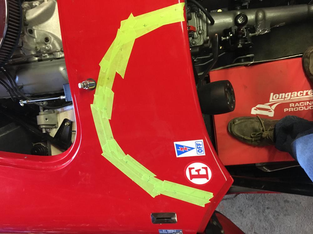

I placed the race screen on the car and laid out where it would rest with masking tape and marked the holes for drilling.
http://www.clubcobra.com/forums/pict...=17516&thumb=1

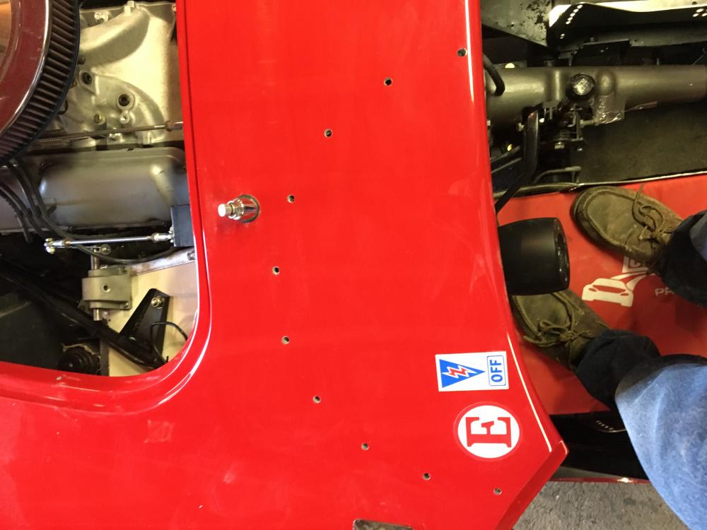

I then carefully drilled the holes, first check underneath the dah to make sure that nothing was in the way, luckily noticed that the oil pressure gauge line could have been hit by the drill bit and moved it out of the way. I then removed the tape and there was no chipping evident.
http://www.clubcobra.com/forums/pict...=17517&thumb=1

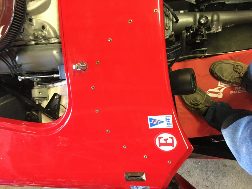

I then went about inserting the threaded inserts. Rick suggested that I ad a little epoxy to the inserts and try not to expand them too far as to avoid cracking the fiberglass. I checked online and found that JB Weld made a marine weld product which would work on fiberglass, so after comparing it to the other choices at the hardware store went with the JB Weld. It was not difficult, but a little time consuming making sure that I did not over expand the inserts. I did have to grind one down and pick up a shorter screw for that one as the hole came out over the main hoop under the dash. I used 10-24 screws that were 3/4" long for all of the holes but that one and used a 1/2" screw for that one, and the race screen was installed!
http://www.clubcobra.com/forums/pict...=17518&thumb=1
http://www.clubcobra.com/forums/pict...=17520&thumb=1
