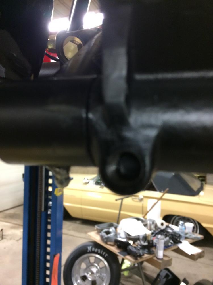

We then started to work on the differential getting it ready for mounting. By adding the bracket, drilling the hole for the safety wire in the fill plug and starting to work on the half shafts. I will be painting the Spicer half shafts this afternoon and hopefully will be working on install Friday.
