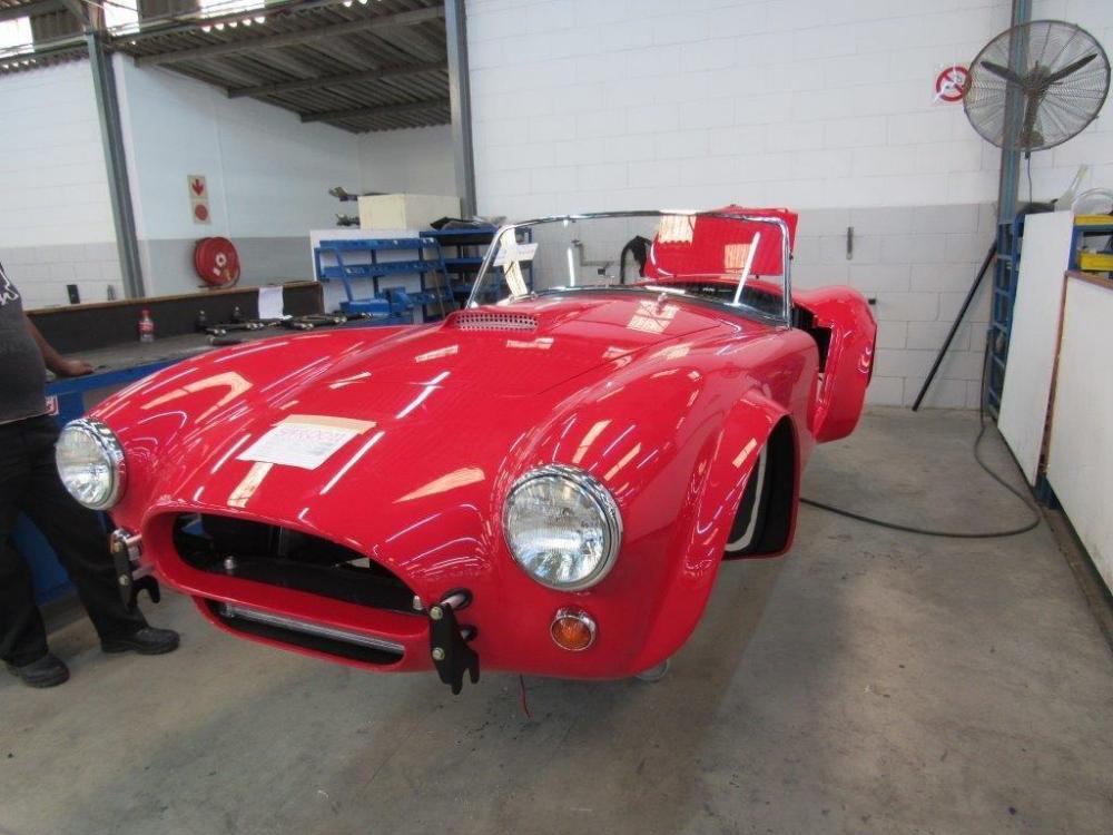

1795 03-02-2017 10:27 AM
Getting closer
It's getting a little closer to done at the factory. Here is the latest picture. Should be completed by early next week and then loaded onto the freighter for it's trip home.

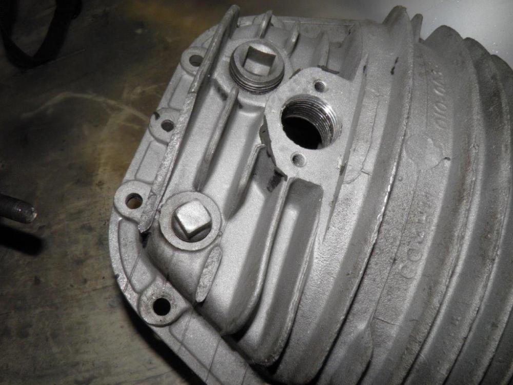

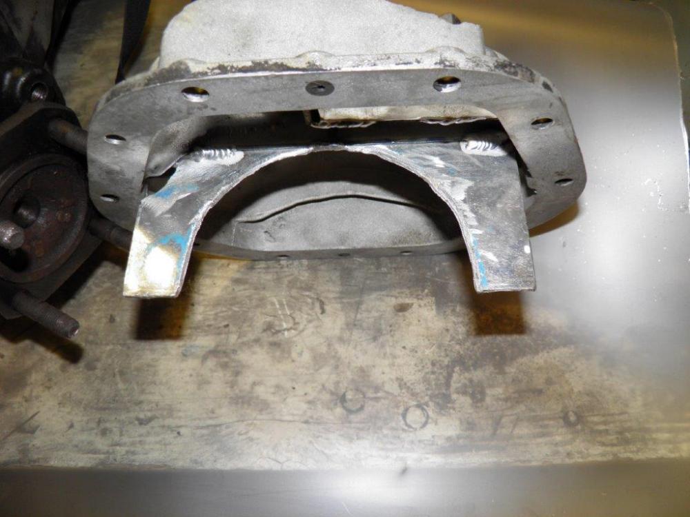

Rear cover!
Well, Ross did an excellent job on the rear cover. We were going to go with the steel cover, and Ross had one in hand, but he suggested that we should try to use the alloy one as it would help with keeping the temperature down with the differential oil, due to the cooling fins and composition of the cover. I concurred with Ross, as we will not be running an oil cooler on the differential at this time.
Ross was able to make the adjustments and welded in deflectors and tapped the holes on the rear cover for plugs. He also added a tee at the top of the differential in case we added an oil cooler at a later date. For now the tee will be plugged. Still have to do some final filing and fitting, but it is a definite improvement over the stock one.

Riverside racer 03-07-2017 02:51 AM
Full credit to Morris for this mod as I have never experienced this issue before. I did not want to drill and tap the case up front for the return of cooled oil as this unit rebuilt already, but would do so if possible in future as Morris points out that would help cool the pinion bearing . Now to tidy it up by grinding with die grinder.
Thanks again Morris and I am anxiously waiting for results once Jim puts it on the track.
regards, Ross

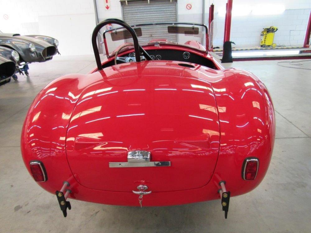

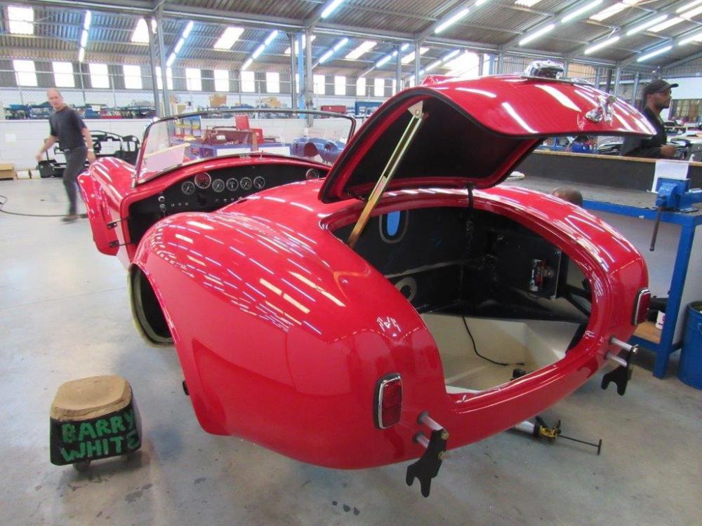

It's finally ready for shipping!
Ross just forwarded the final set of pictures to me. the car is finally ready for shipping and should be on the big boat heading home soon! Where is a transporter when you need one?! Beam it over here Scotty! :LOL:
For your viewing pleasure,
http://www.clubcobra.com/forums/pict...=16320&thumb=1 http://www.clubcobra.com/forums/pict...=16321&thumb=1 http://www.clubcobra.com/forums/pict...=16322&thumb=1 http://www.clubcobra.com/forums/pict...=16323&thumb=1 http://www.clubcobra.com/forums/pict...=16325&thumb=1 http://www.clubcobra.com/forums/pict...=16326&thumb=1
My work will be starting soon! Now I have to sit back and wait. Race seat, fuel cell, fuel pump, and a few other parts will be arriving today and the harnesses, fire system, kill and start switches should be arriving by next week.
Jim
