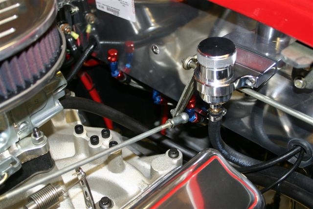

Here's another approach:
I bought the reservoir from a street rod supply shop off the 'Net. Of course, I got it home and then realized that the bracket it came with would not protrude enough off the firewall to clear the throttle linkage. I then reached out to fellow CC member Rob Frink and he (based on my drawings and measurements) CNC machined that neat little spacer that you see against the firewall. Bingo...instant, leakproof reservoir. BTW, this photo does Rob's work no justice, as it's actually a triangular shaped spacer with different depths.
It's been so long, I honestly don't recall where I got the reservoir from. Rob may still have the CNC program to whittle another, but you'd have to reach out to him.
-Dean #747

Dean - Thanks for the idea. Did the width of the reservoir bracket match up with the holes on the firewall (after passing through the spacer)?

Doug, I designed the spacer to utilize the existing holes on the Wilwood bracket. However, they only matched up for the lower portion of my custom bracket/spacer...I had to drill new upper holes to get it to mount properly. That's the only bummer on this option...held in by four bolts. But at least it's not going anywhere!
