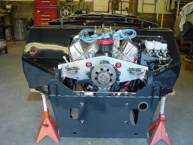

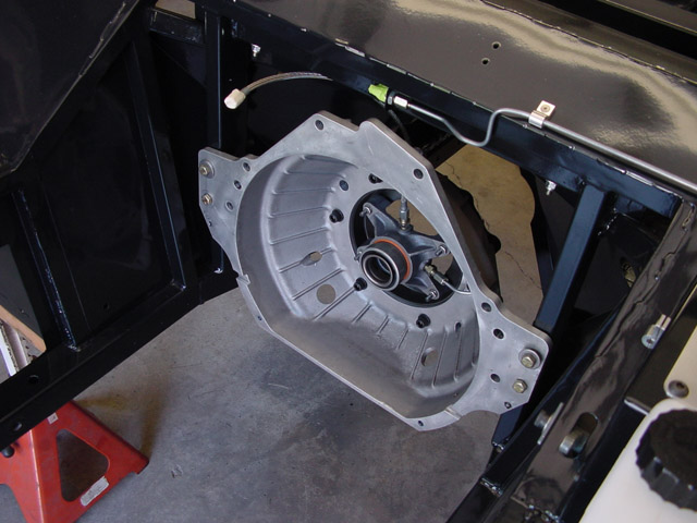

My JBL is a solid mounted configuration using a front motor plate and special bellhousing. Tail shaft is soft mounted, of course. In my case, the engine block is a chassis stress member: adds to the torsional rigidity (stiffness) of the chassis. It’s as smooth as silk with very little vibration and not one loose bolt in 6500 miles. However, the rotating assembly was neutral-balanced, and not externally balanced as most Fords are. Other than for strictly drag racing, this is a key component and requirement for solid mounting in my opinion. The motor is much happier for it too.

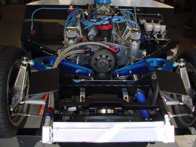

It’s very basic. When bolted together, the engine, bellhousing, and tranny become a beam. You want to fix the beam at two points only, meaning: front & mid mount or front & tail housing. If you were to fix the beam at three locations (front – mid – tail) somewhere along those 3 points will get stressed and most likely fail. You are not mixing solid and soft mounts in this case. The soft mount at the tail housing allows it to float and absorb any movement given the beam is already fixed at two points (front & mid) and the tranny is cantilevered. This is a typical configuration and works very well.
Mid Mount:
Front Mount:

damn john, if that ain't the sh%t. that is a very cool set up. and you are 100% correct.

Best way to do it: as described by jmarsey. However, can you still change the clutch w/o taking the engine out?

Thanks for a great explanation and for the super pictures. Nice setup!!!!
