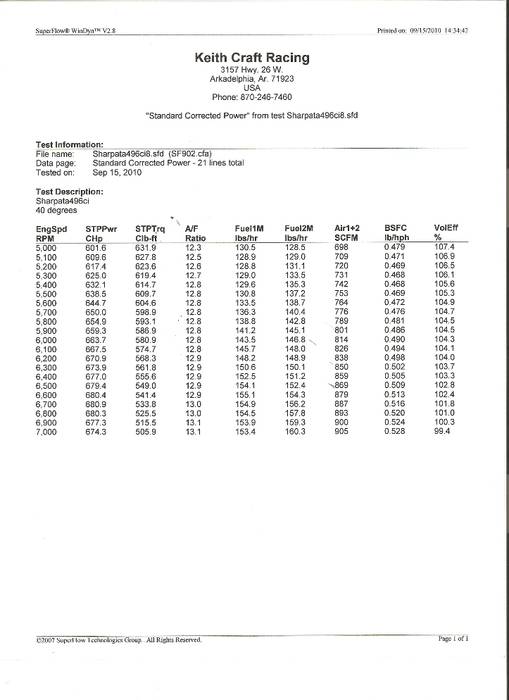

Well Keith finished my 496 all aluminum FE, solid roller with stage 3 heads, victor single plane and Quickfuel 850........Dynoed at 680.9HP and 6700 rpm and 631.9 tork at 5,000 rpm. Ye Ha here we go....
Was going to post the dyno sheets but PDF files were too big to upload...will need to figure that out. Update: Here are dyno sheets and pic of the engine...

Ask him to post what the settings on the dyno were too. Were they zero'd out or "tweeked". See what the chassis dyno says when you get it home and on the street.

WOW! peaked at 6700, that is a pretty impressive setup for that many cubes. i'll bet the tq. was there from the start also. very nice. follow kc instructions and take care of her.

I have Goodyear Billboards on it so will start with those. I wanted a FE that would spin more like a small block and kill some of the tork down low. We went with a single plane victor manifold and Keith cut it down 1/2 inch for hood clearance and also a solid roller, stage 3 heads and aluminum flywheel. Keith knows I wasn't driven on HP but more the combination and what ever it came out at would be fine. I try to down size the dyno sheets and post them later today.
