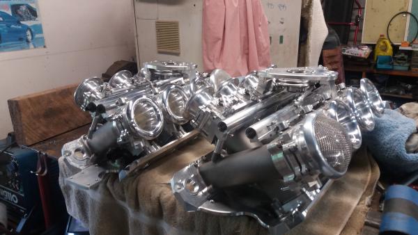

Go EFI , my new intake .http://www.clubcobra.com/forums/pict...ictureid=18217
302w at the back 46mm and 351w 52mm , I made the ring that the mesh fits into .
