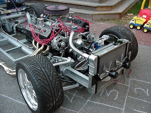

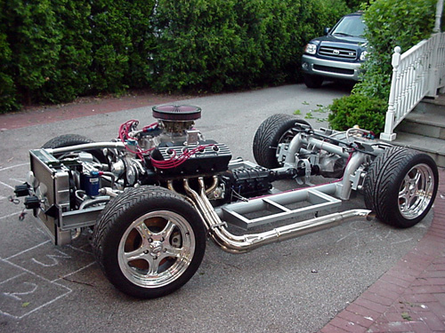

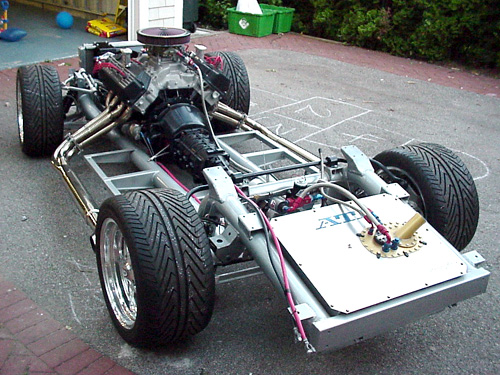

Got a letter from my buddy Brett over there this past week indicating some plans for their comeback. I have some contact information if you are still interested. I also have the manuals that cover all 3 suspensions they offered: Vette, Jag and Mustang. I went with the Vette and swapped in some coil-overs. At some point, I heard of some clearance issues with the BB engines and with this monster I didn't want to take chances. Also had a 9 quart Aviaid road race pan made for the 528 to save about an inch under there.
Anyway, I hope they come back... as you can see I'm missing an important part of my car:
Hope all is well with you guys in the club, I'm sure I'll make it to a meeting soon.
