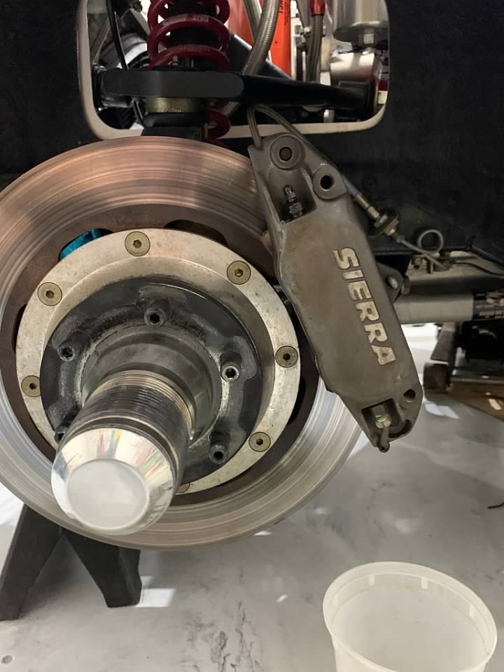

I didn't realize but I have the Big Brake front end, which I believe is a 4 piston?
Bob P said they have several replacement calipers on order - so in the meantime, we're going to flush the brake lines, bleed out and run clean fluid and this should be a vast improvement over current condition.
Here is my front brake...
https://uniim1.shutterfly.com/render...&ts=1657838743

Join Date: Nov 2003
Location: New Britain, CT
Posts: 3,032
We used the Sierra Calipers for quite a few years. They had 4 x 1.75 pistons. For some reason, we changed suppliers (probably because we couldn't get those any more). We currently use essentially the same caliper, made by Wilwood (120-11136). I wouldn't be surprised if their rebuild kits also fit the Sierras.
