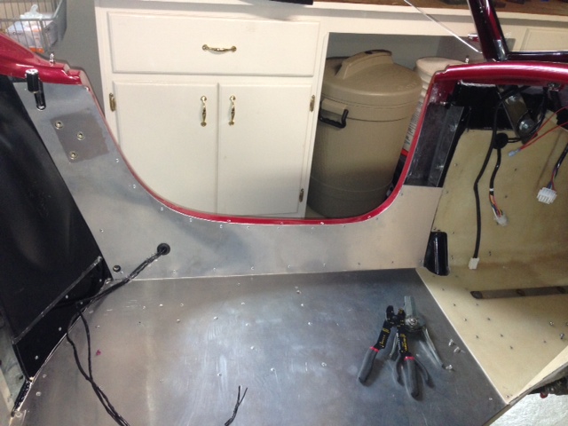

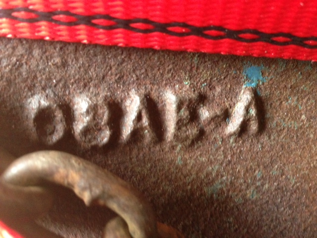

Due to work and other commitments, I haven't been able to get out to the garage much to work on the car. However, I did reach another milestone and have the beginnings of an engine. A local Cobra owner - he's active on this site, so I'll let him chime in if he choses to - had a '68 side oiler short block for sale and also told me about an engine builder in the area. I researched the engine builder and he has been building FEs all his life and, although not active on any forums (he doesn't even have a website), he has racked up a number of very positive comments about his work and abilities with FEs. He's been referred to as the "go-to guy" in the area for the racing crowd. Anyway, I picked up the shortblock yesterday and will be taking it to this engine builder to have it magnafluxed for cracks and possibly pressure tested. The motor came out of a Chris Craft and seems to be in very good shape (closed cooling system). There is only a bit of surface rust in one of the cylinders but not an issue.
[img]http://www.clubcobra.com/forums/picture.php?albumid=1229&pictureid=9811[img]

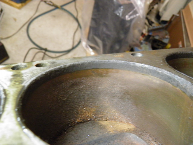

Leery about boat engines but certainly have it sonic-wall tested too. You don't state the bore size but it may have been bored to where it's too thin and have no rebuilds left in it. Or no thrust side face left.

Chas,
The motor had not been opened up since new until this week, so still standard bore. The engine builder will check it out thoroughly before committing to a build, so I'm taking it one step at a time.
Thanks for the input, much appreciated.

Just remember most boat motors run cold all their lives so bore wear from rings very possible.
Best luck...

Kevin, red Cobras rule! I hope your block comes out clean... are you going for period correct look? Double carbs? Can't wait to see it...

Since it's never been bored, I'm assuming there will be room to play with. The engine builder is a machinist and will be able to tell me exactly what I have. Thanks for all the tips.
Hector, my car has aspects of the S/C and street car (double round taillights, street dash layout, for example). So, I didn't pattern my car off of any one original. I'm going with a single carb.

kevins motor is rather nice, i disassembled her for the first time since ford put it together. it's a 1967 cast date side oiler, std bore , no ridge. as far as running cold most of its life....i doubt it. no sludge on the inside at all, very clean. heads had fresh plugs in it and new wires, it was a running motor. normal rotation......
nice green coolant flowed out of her when i pulled the heads off.
so he's got a good cast crank, 428 rods....really good starting point.
now to get rid of about 2 tons of marine cast iron i pulled off of it
the side oiler part was unusual normally they are just hydraulic blocks, but the oil galley is there and has the relief valve.
once its built and painted, you'll never know it came from a boat.

Assuming it passes the tests, a minimal "clean up" of the bore, and then stroke it out, and you will have a wonderful engine for that car.

I would come back at you about the profile change because I just brought the block home last night! But, I probably wouldn't have thought to update it, so good catch. Thanks for the well wishes - I'm looking forward to it.
Patrick, if the original crank and rods are in good condition and can be made "good as new", it would be cool to use them. Will discuss that in detail with the engine builder at the appropriate time.

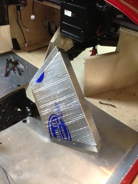

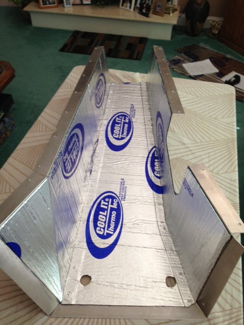

Heated seat wiring harness - relay and fuse blocks mounted on chassis rail behind dash. Wires to seats fished through side panel and out a grommet. Will wait until the carpet goes in to solder the seat connectors on so I can make a smaller hole in the carpet. I'm about 90% done with the wiring. After reading Dan's thread, I have my fingers crossed that it will all work!
Insulated tunnel and front tunnel cover.

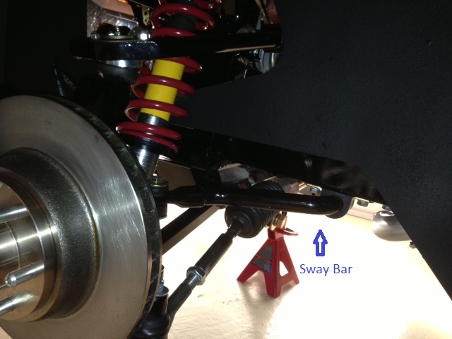

Installed front and rear sway bars. Labeled the installed sway bar because I have some friends following my build who wouldn't find it otherwise

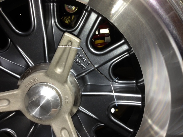

Mounted rear wheels and made first attempt at safety wiring. After seeing scratches on a couple cars apparently from the safety wire, I used microtubing where it touches the wheels and spinners. Safety wire is .031" and the tubing has an inside diameter of .032", so it fits like a glove. Overkill perhaps, but so what...
