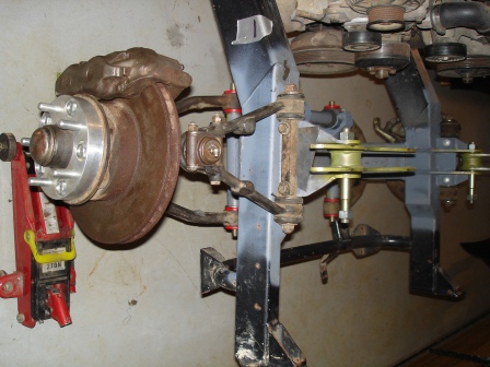

I looked in your gallery and saw that pic. You look to have the 78-87 XJ6 suspension. http://www.welshent.com/catalogs/welsh_xj6.pdf
The top ball joint has shims that can be rearranged to move it fore and aft for some minimal adjustment. I would see about plug welding the mount holes for the upper arm and redrilling them or if your lower is an easier move look into that. I would shoot for 4-6 deg of caster. More caster will give better self straightening but heavier steering at lower speeds. Nice results on the minimal bump.

yeah, its an 84 xjs front. its not possible to redrill the top mount as the upper arm bushes(bearings) straddle the mount plate with only minimal clearance so it cant be moved. bottom is the easier way forward. the shims are full forward so nothing left there, and I need 15mm(drew it up on CAD) to get 6deg so not enough in shims anyway.
