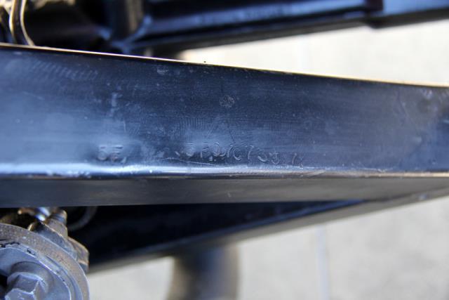

Here's the VIN # in the ad: 5F07C735272
Isn't this a VIN # for a 1965 2-bbl Hardtop Mustang? If I were a buyer, I'd be curious if you could use this VIN # for registration or not. I'm not sure you could in CA.

Well, it's stamped in the frame so it must be legit.
Isn't it amazing how things evolve online once the light shines on something? Any legal types here know the ins and outs of putting a mustang vin on another car? This pic is from the vanguard site. I didn't think FFR put their numbers on the Xbrace?

The VIN: 5F07C735272
Decodes as follows:
5=1965
F=Dearborn Assembly Plant
07=2dr Mustang Coupe
C=289 2V low compression engine
735272 is the production line number, usually starting at 100001
In this case, the original owner of the car used an existing Mustang Vehicle Identification Number (VIN) to register the car.
It is my hope that the car the VIN came from is no longer in existence, as to have two vehicles with the same VIN, being actively titled in the federal database will cause all sorts of headaches for the owners.

A VIN is stamped into the frame of a vehicle, thus identifying that vehicle with that decodable set of numbers and letters unique to that particular vehicle.
A Warranty plate is not permanently affixed to a chassis (pop rivets or rose rivets are not permanent), thus when you see such a plate mounted on a drivers door (in the case of a vintage Mustang)
The warranty number is the identical number/letter combination to the VIN permanently stamped into the chassis. You'll notice this tag is also marked below the VIN: "Not for title or Registration Purposes", again the reason for this is because it is not permanently attached to the chassis.
Hope this answers your question(s)

No, you can't legally use an existing chassis number on a completely different chassis/vehicle. It's a Federal offense.
