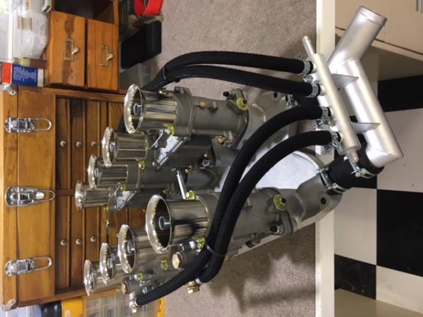

I finally broke down and decided to get a set of 48 IDA's for my 289 Cobra. It was great working with Jim, and he did an amazing job building my carb setup. Hoping to install next week after I get all the pieces and parts together to make it all work with my current setup (trying to keep my heater and bypass while running the dual neck fuel log) I promise to post lots of pictures of the install for now this will have to do.

You'll notice the difference, right off. Looks like a great setup!

Congrats! Looks great and can't wait to hear how the car performs. Would like to get a set of 48 IDA's for the race car some day, but that will mean a whole new engine as not only would I have to switch out the carb and manifold, I would also have to get a new cam as the lobe separation on this one is outside of the range that IDA's like. With all of those changes, might as well have a second engine. Enjoy.

I see you went with side drafts......

My advice with carb fuel hose is run them down hill to the front, so the banjos are definitely the highest point per carb.

Thanks for the advice on running the fuel lines. As far as the side draft thing goes, I cannot figure out for the life of me why all the pics I try to upload to this site end up being sideways.
