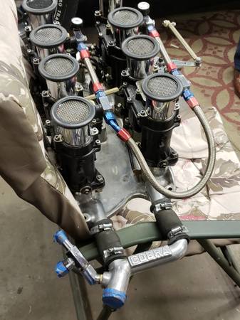

With that laid out, I came across a complete Weber system for a reasonable price. I have always loved the sound and looks of the webers on a SBF! I know they are much more difficult to set up and keep tuned. But what a sweet sound!

I have been down that road and still on it. My opinion is the only benefit the webers will give you over your current set-up is appearance. I hear many people say they like the way webers sound, my hearing must suck because I can not hear anything different over the exhaust or the wind from open cockpit.
Tuning can be quite extensive unless you just get lucky, 4 jets/bleeds per throat, 8 emulsion tubes, 4 accelerator bleeds. Average cost for each, $8
Linkage setup is very critical, I found that cross-bar style as your photo shows to be inaccurate.
However, once the carbs are set, there should be no further adjustments, they operate like any other carburetor.

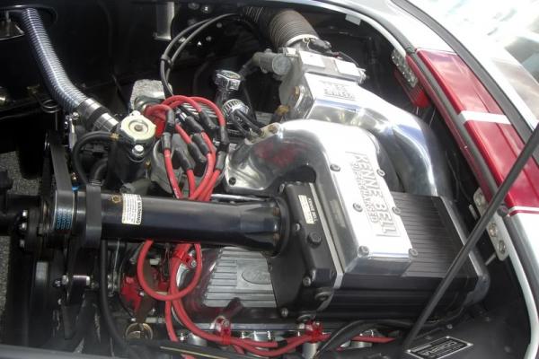

Thanks for all the feedback. I think I will stay with the Kenne Bell supercharger. It seem more tunable and the added power doesn't hurt!

Looking close, I see electrical connections in the center of the manifold, the system might be a FI/weber conversation. The real expense if it is, is the ECM to control it.

Posts: 366
After closer inspection, I was concerned the offer was not "real". So I backed out making an offer. Pisses me off when these scammers place these ads!
