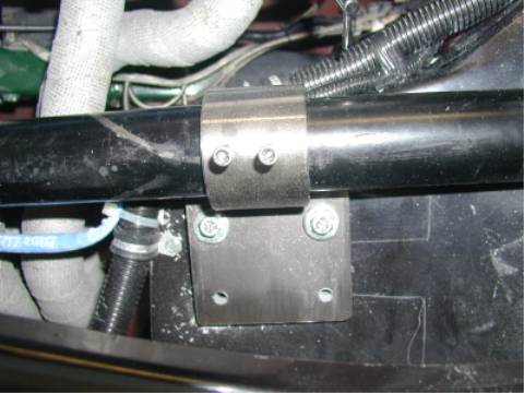

So i looked under the dash. my flaming river column is mounted to the cowl mount bracket by a muffler clamp and a piece of rubber where the clamp touches the column. now there is space above the column so actually the column is just sitting on the clamp. The upper part of the column is probably touching the opening to the dash. Under the hood is the normal A&C setup with the muffler clamp and bracket along the footwell. That area is tight. i can move the steering wheel left to right.
With my front end, i was really thinking on replacing the front shocks because of the left rubbing problem before. Maybe the shocks are dead and thats why it lifted.
How did you guys mount your steering column under the dash to the cowl bar.

here is my column set-up i bolted two pieces of threaded rod to the bracket on the cowl bar then used two muffler clamps one on top and one underneath to hold the column

I will be using that threaded rod muffler clamp style for the steering wheel. simple but perfect.
