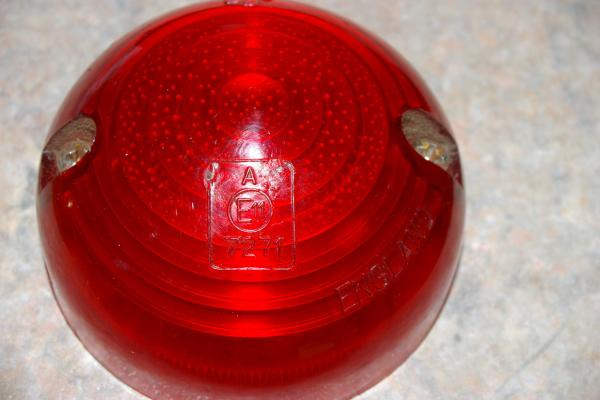

G'day, Can anyone tell me if these lights are going to be legal in Victoria please? If so what were they off originally? (they came with the car so I don't know)
Also are parking lights inside the head light acceptable too? Thanks, Peter

My engineer tells me that as long as the lenses show Ew then they're okay.........but I'm in Qld but the ADR is the thing, and that's national, so they should be okay

They look like Land Rover lenses...they passed for me in NSW as well as the parkers in the headlamps. When I registered my car the lenses had to have the euro 2 symbol moulded into the lense. I'm sure someone else will add to this info.

Yes they seem to be Landrover lenses - I got those for $5.00 each at the local supplier and they were ADR compliant.

The lenses need to have an E stamp with some coding on them. Agree that your lenses look like the domed symetrical versions used on the landrovers. Very cheap and legal option to use for compliance.
This E stamp was one of the items Enkelmans paid attention too during my inspection.
Internal sidelights in the headlights is legal and ok.

You can buy compliant E marked L691 and L692 lenses now Slowy. Mine went through engineering OK with them.

I tried clear lenses with yellow bulbs for engineering but they were rejected. There is a number associated with the E marking and the engineer looked it up and found these L691 clear lenses were for Parking lamps. They had to have the right number for indicators.

If the lenses were from a landrover then they weren't L691's I'm guessing and so probably had an E stamp.
If you look at the codes on the indicator and stop lenses they should have different codes indicating use such as Mike says.
The clear Lucas L691's code indicates parking lamp use only, not as an indicator, and this relates to the way the lens refractory properties have been developed and made for the lens to operate.

I even used the same engineer as Geoff. All my lights are PERLI and the indicators are E11 stamped and (O1A) 7271 numbered. I originally had orange ones, but changed after asking the engineer.
I even asked the QT guys and they were happy.
