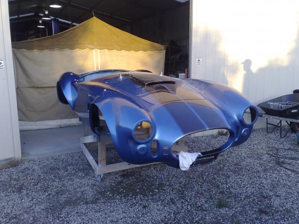

08-15-2010, 02:17 AM
Join Date: Apr 2010
Location: melbourne,
vic
Cobra Make, Engine: Robnell Blown LS1
Posts: 296
Yep $200 well spent, had my doubts at first but it worked a treat.
Paint one week, 21st the next, pretty darn handy.

Niiice ! What's the colour ? It looks very much like the colour I've picked for mine. Mine's a Glasurit colour...no name just a number.
08-15-2010, 04:42 AM
Join Date: Apr 2010
vic
Posts: 296
G'day Rob,
The color is Lexus spectra blue Mica and the stripes are BMW sparkling graphite.
The pictures don't do the color justice.

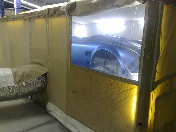

What did you use for filtration on the tent? Anymore pics of how the airflow works (inlet and outlet). Was there much of a smell outside the tent?
Thats a fantastic idea. I am planning on hiring a booth, but your set up looks like it might be a better way to go.

08-16-2010, 06:03 AM
Join Date: Apr 2010
vic
Posts: 296
G'day Guys,
In the picture you can see the commercial aircon duct which went through the entry door outside, at the end of that is a large single phase fan in a housing which vented through some filter material (DUE TO EPA REGULATIONS), we left the window closest to the duct open which then let enough air in and was'nt being drawn over the body. We were spraying when I took the photo ! There is a small gas powered heater on the opposite corner inside the tent ( I reckon it was about 50 deg in there when painting ) and we kept the floor and surrounding area wet, pressure washed the whole thing inside prior. Must say I was sceptical at first but it worked a treat. The Dupont rep had a look at it afterwards and stated there was less rubbish in the paint than jobs done in a $100,000 booth. (PREP). We replaced the centre pole with an eyelet and hung it from the roof, so no obstruction. Shut all roller doors and as many gaps as possible.
Only one thing occurred to me afterwards was:
1. open flame. (Heater)
2. paint fumes (Flammable)
3. For some reason my wife had just increased my life insurance. (Hmmmm)
Back to the car !!!!!
