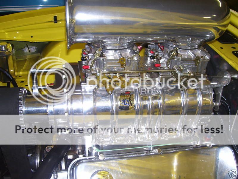

ICE, I've always wanted a proper roots blown car and finally bit the bullet last year. Visibility in a Cobra might be an issue
I've had a B&M144 blower on a 302W. It had low rpm torque like you wouldn't believe. The offset drive (to clear the distributor) means that the blower drive / pulley will likely foul on the bonnet.
I'd use the Eaton if you have it already. The M2300 will take some fabricating, but it's a pretty wild blower!

WOW...love the old B&Ms...used to have a 6/71 on my LS6 454 20 years back...
I understand that there may be an adapter plate required and have seen some examples online from the Eaton 1900 set up. I will have to do some more homework on the injection set up though and that bonnet on the DRB snakepit will need some reworking...I so love GRP

ICE if you've had and love the 6/71 ....Have a dig around and look for a V6/71 same internals...but the base plate isn't there and you can mill out and down a Bronco Lower Plenum and then weld a mounting plate on for the case....
45 +degree Dissy ,modify an old echo Whipper snipper head
Also a few injection options and the best thing is it will all fit under a COBRA BONNET with a ever so slightly bigger scoop which I reckon looks better anyway!!!
It can be done!!!!

ICE, I've always wanted a proper roots blown car and finally bit the bullet last year. Visibility in a Cobra might be an issue..
C'mon You have the perfect scoop for it !! was it really an issue!!...the only scoop i've seen bigger to yours was the WEINECK 780ci !!!
