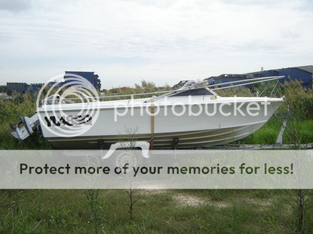

Ok a few boat pics as promised.
A Haines V17 R - recreational as distinct from a C as a cuddy cabin or L the luxury version

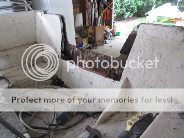

Some before and after transom shots

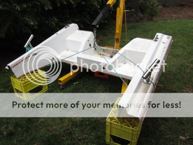

Top chopped for easy access to this mess

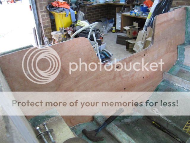

A layer of 15 and 17mm plywood to replicate the original 32mm thick transom.
When I thought I'd manage to own a "topless" boat I know I wasn't thinking of it in this fashion!!! OMG

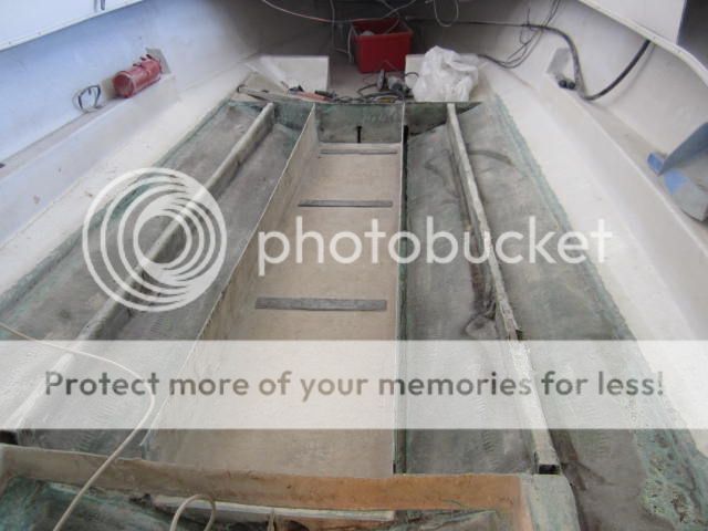

Partial floor removal, the centre section has since also been stripped out, more to better accommodate the internal fuel tank!

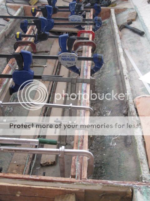

And finally rebuilding has started in ernest - a garage and heat source are essential this time of year! burrrrrrrr
Have to mention that the old Rude-Evin 80's vintage outboard in the original shot is also to be replaced by a 2001 135HP Johnson.

Geez Slowy thats a hell of a job you've taken on!!!
That central area is that the space you mentioned was completely ROTTEN and void of TIMBER!!...one good wave and crack Commodore Slowy would be going down with the ship!!

Handy storage area you have in the 1st picture!!!!

Nothing dry about the rot that was there, every piece of timber was thoroughly soaked, wet and crumbling from extended immersion. The ply was delaminating or rotten mostly.
But the construction is timber insertion into a fibreglass mould ie the laminated glass hull, so the foundation to it all is untouched and the new timber just brings back all the torional strength and rigidity except of course that the transom can now carry a heavy outboard safely again.

Not too difficult a job as it is all sheet plywood I simply need to cut to shape or size. Using 15mm generally but added a 17mm layer for transom strength, though there was an intermediate fibreglass layer I couldn't replicate. Don't see this as detracting from the 32mm laminate though.
The storage area is in one of my company's yards and was the drop off point when the boat arrived on the back of a truck from Qld.
