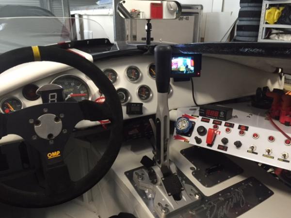

I had a spare camera on my shelf so I installed it. Should make reversing into pit sheds a bit easier. With hans and seat I cant see anything behind me.
http://www.clubcobra.com/forums/pict...ictureid=15218

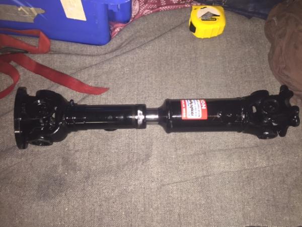

- Tail shaft measured and made using 1350 series slip yoke assembly.
http://www.clubcobra.com/forums/pict...ictureid=15307

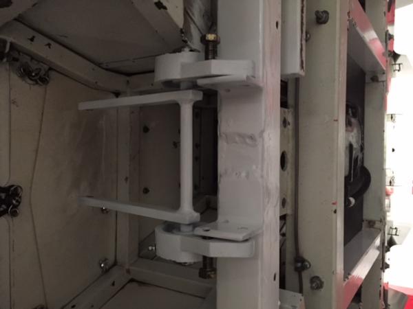

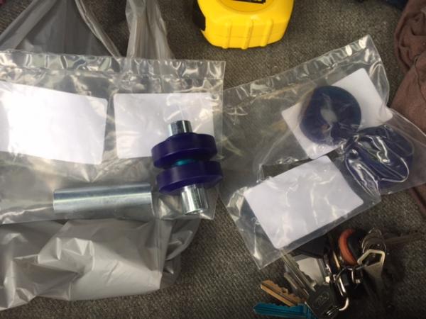

- New cross member fabbed with new bushings and crush sleeves.
http://www.clubcobra.com/forums/pict...ictureid=15308
http://www.clubcobra.com/forums/pict...ictureid=15328

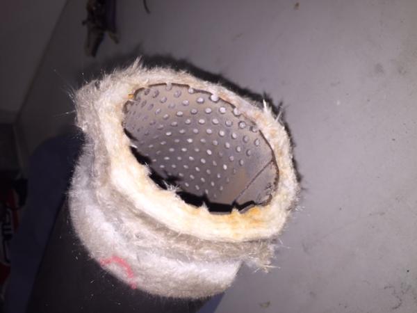

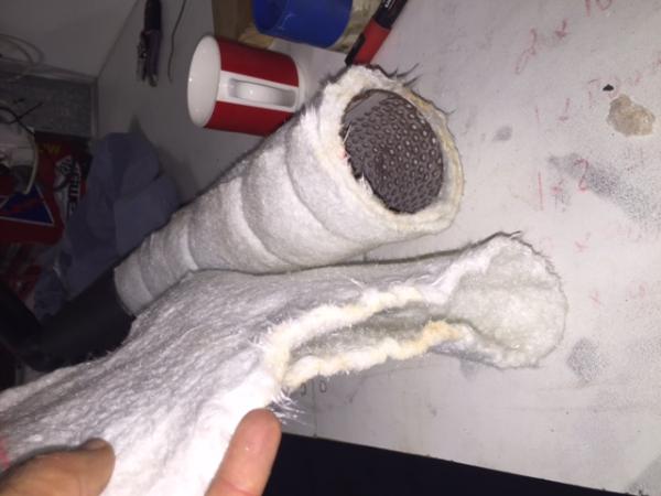

Ive also pulled the side pipe off, ordered in new flange gaskets and repacked the pipes with fibreglass mat to keep the noise down.
http://www.clubcobra.com/forums/pict...ictureid=15326
http://www.clubcobra.com/forums/pict...ictureid=15327

More pics added above. I know my welds aren't pretty but Im learning and with a single phase 130amp stick welder they could be worse!!
While I was at it I hand made some exhaust body flanges to cover the edge of the glass where they exit the body. Stuck them in the oven to 100+ degrees and then applied stove paint. They came out pretty good. And the paint is HARD.

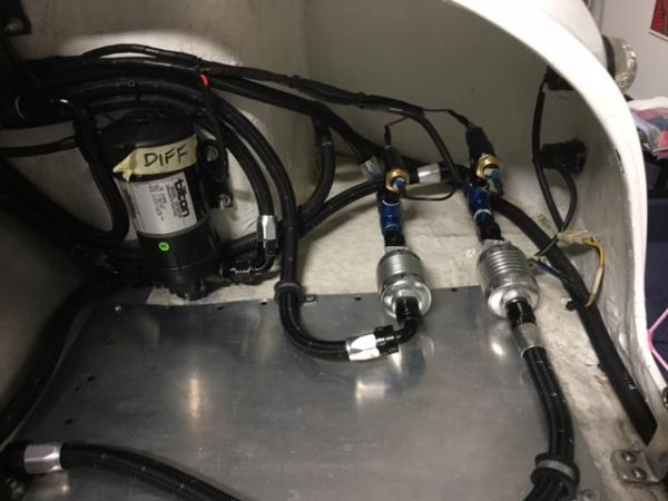

http://www.clubcobra.com/forums/pict...ictureid=15164
Well first problem. While my snake pit of lines looks pretty I cant get the pumps to prime. Ive installed as per Tilton Spec and these pump drawer up to 8 feet above the primer source so I cant figure out whats wrong yet. Im onto Tilton tech for a solution. They advise to run the pump last i.e. diff out, filter, cooler, pump and diff return. I cant seem to get past inlet cooler.
Somethings up...just not sure yet. Urgh
dallas_ 05-10-2016 04:34 PM
Try blowing out the lines from the far end back into the tank.
If you get an air bubble, sometimes the pump can't get good suction.
SydneyChris 05-13-2016 12:39 AM
Exactly.. they can draw up to 8ft of fluid, not air.. :). I used a low pressure pump into a swirl pot to ensure the pot was always primed then gravity fed the 044 connected to the reg. It may also help to use a non return valve on the fuel (as I'd expect you already have on the brakes).

spookypt 05-13-2016 12:44 AM
You know this is oil right? Cold oil in fact. Spoke to tilton and the issue is the cooler outlet being higher than the pump.
I've amended the order to diff filter pump cooler diff and all is good. Tilton prefer pump last due to heat but I won't be doing the 12hr any time ever!

Aussie Mike 05-13-2016 01:55 AM
That's the way I have mine set up: Diff - Filter - Pump - Cooler - Diff. My pump is a Genesis which looks identical to the Tilton.
You may want to look at putting a check valve in there to stop the oil draining back to the diff. It'd make getting the system primed and running again quicker. A hinge type is full flow and adds very little restriction to the oil flow. I have a #10 one of these on my engine oil cooler setup.

spookypt 05-13-2016 02:30 PM
Mike I was talking to the Motorsport guys about a couple of flapper valves for this set up. I assume running as close to the source (diff or trans) as possible?
Aussie Mike 05-13-2016 05:16 PM
Yep, I reckon placed below the level of the diff oil so it's always full and then you will have a head of oil sitting on top of it. The pump should be able to draw straight away.
SVO 050 05-15-2016 03:04 PM
Any hydraulic system needs a flooded suction at all times, any cavitation will cause loss of prime and potentially damage the pump.
A trick is to ensure the suction line is larger than the outlet, increases the volume of fluid on the suction side of the pump.
Just my observations after working in the hydraulics industry for ten plus years.
