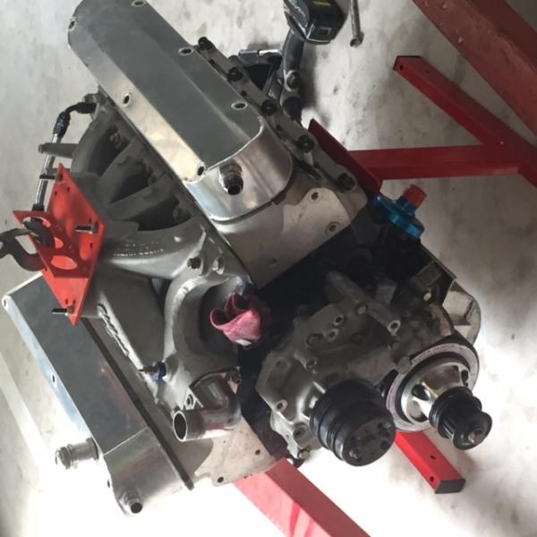

Engine out. Time for a rethink!
http://www.clubcobra.com/forums/pict...ictureid=15904
Hmmm, I think the cam follower and cam lobes have decided to have a party!
http://www.clubcobra.com/forums/pict...ictureid=15905

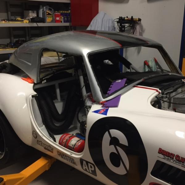

New HT with 6 point cage to be made.
http://www.clubcobra.com/forums/pict...ictureid=15906
Lots to do!

Engine report.
2 x collapsed cam follower rollers. Cam lobes damaged but caught it all early. Will be binning cam pistons valves rockers crank etc and starting with block and heads only. Some scoring of one bore. Otherwise all is in good nick. Now to work out a good race combo that works without too much stress. Rpm will drop from 9 to 7 tops and comp 11 to 1 ish. More updates to follow.
750hp 10-30-2016 05:47 AM
You don't really mean binning, do you? What's wrong with the crank?
spookypt 10-30-2016 02:19 PM
While still functioning it looks to have had more hits in its life than Elvis. I'll consider its future once I decide on combo.

spookypt 10-31-2016 08:11 PM
Yep sadly so. That 2000rpm will be the difference I think between 500km between builds and 3000ks I hope!
Im enjoying what I'm learning about engines. This car has taught me a lot about things I never thought I'd need to know. Its all part of the "making it reliable" phase.
