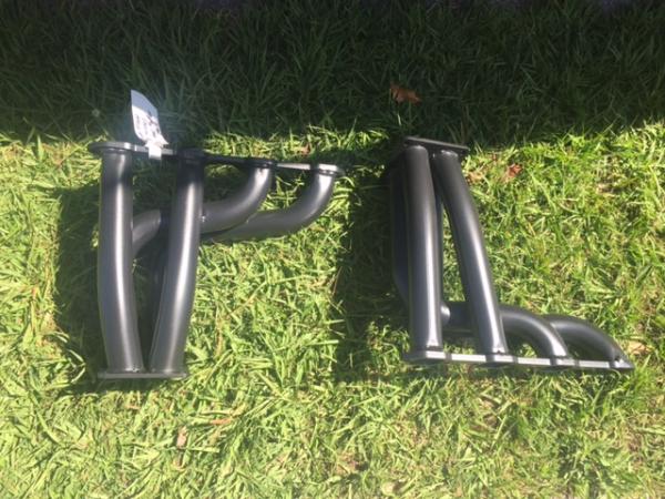

- Headers repaired and HPC'd
http://www.clubcobra.com/forums/pict...ictureid=15952

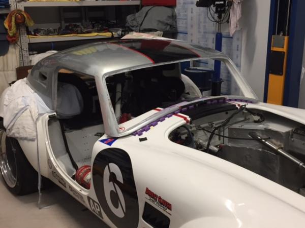

- Roof modded to fit helmet and roll bar hoop.
http://www.clubcobra.com/forums/pict...ictureid=15953

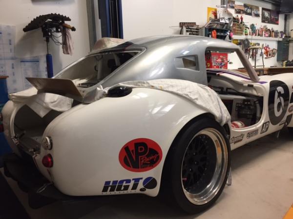

- Roof bulge profile and new Naca duct inserts both sides for diff and trans coolers. Fitting the windscreen and rear screen this weekend. Big thanks to Ash B Towmaster for the deal on some stout acrylic.
http://www.clubcobra.com/forums/pict...ictureid=15954

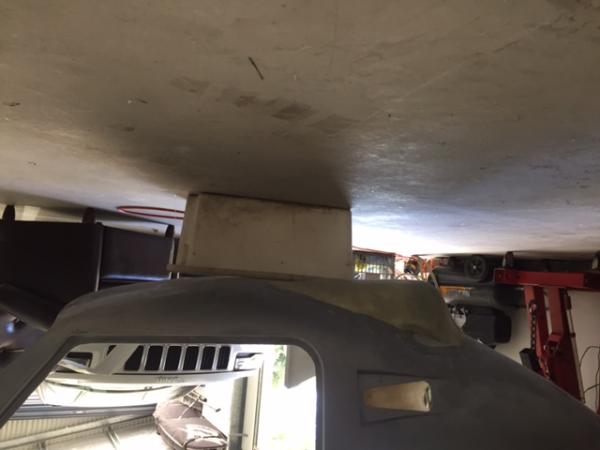

Well despite spending most of my awake hours working Ive managed to now finally have the roof ready. Woke up at 4am Saturday and finished the sanding and put the bolt holes in the body to affix. Measure a million times...then drill.
What was throwing me was I just couldn't get it to line up as I wanted and then I realised the RHS A pillar was 25mm thinner than the left. So after lots more fibreglassing this is the end result. Gurney bubble for helmet and rear hoop clearance (I kept the rear hoop as its integrity with the existing cage will make CAMS log booking ALOT easier) naca ducts inserted for rear coolers, new RHS A pillar, rear lid with duck lip spoiler and all windscreen cut and predrilled once painting is done.
No I wait for Peter B to come down, work out the final design and order materials then its off to his workshop. Final pics of how it will look below less paint.
