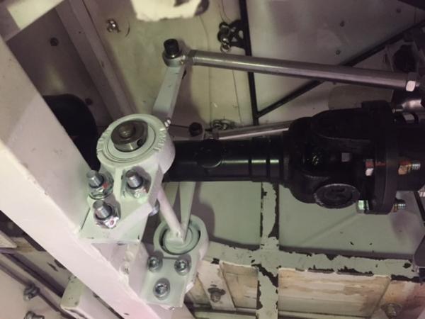

The weekend report. Well new box is IN! I got skunked on the TOB clutch lines so I had to pull the bellhousing off to get them attached but its in. I missed that little issue when I was planning the install. (Set me back a few hours) Hooked up the shift linkages, cross member, clutch line, driveshaft and tail shaft hoop. Connected the trans cooler lines and breather and its all worked out A1. Fitted without any mods.
Now I have to reinstall some proprietry items and then prime the trans pumps and do the basic electric fit off before it goes to Peter H for final electrical fit off. Once that's done its back to my house for a valve lash and brake/clutch bleed before we go have some fun and the consistency STARTS! (Fingers crossed)
Sadly, Pete is going away so if I cant get it all done before he goes I'll miss the 3rd round again. Ive resolved myself by saying that it doesn't matter as I want start afresh, no rushing, everything working and insitu as it should be. So if I miss it I miss it. There'll be plenty of opportunities going forward.
That said I'm working on it every night this week so I'll be pushing hard to make it to Pete's before he goes away.

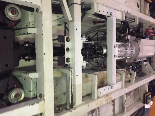

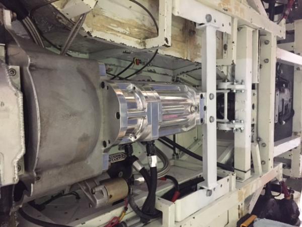

spookypt 05-30-2016 07:04 PM

spookypt 06-19-2016 06:21 PM
Well weekend update. Started it! Yep after a long hiatus the beast started and I ran it up to temp twice (15mins worth) and then dropped the gb oil and replaced. No swarf and all smooth. Not that you can really tell on the hoist but wow it feels smooth a slick and very short change throw.
Cant get my shift counter to work as yet but Im working on that. Clutch is bled, brakes are bled and now just to do the final wiring by Pete. Once I get my new trailer so as I can take it to him.
Interesting the engine seemed to get hot rather quick so I back pressure flushed it with a compressed air water hose and managed a match box full of silicon. Running a lot cooler now.
http://www.clubcobra.com/forums/pict...ictureid=15534
