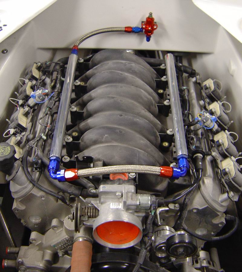

Hi All,
The LS1 normally runs a single fuel line from the tank to the motor. The pressure regulator is in the tank and there is no return feed from the motor.
I want to run an extrnal swirl pot and an extra fuel pump. I also want to run an extrnal adjustable fuel pressure reg and generally beef up the whole fuel system. Part of this was to run a full retrn fuel system like conventional EFI systems.
So here's a pic of my home made fuel fails. You can buy the aluminium fuel rail extrusion by the meter. I've machined it to suit the injectors on th LS1 and threaded the ends for the speedflow AN8 fittings. Phil kindly donated the elbow fittings for the cross over and I put them on a new bit of braided hose.
The regulator mounted on the firewall is a SERD unit from Japan and they are popular with the big HP Turbo combinations so should be plenty big enough to support my motor.
All I've got left to do on the rails is make up some brackets to support them off the manifold.

mmmm, more polished shiny thingo bits, more room on them for advertising....
Still long enough for Better Bathrooms & Kitchens 03 9370 xxxx, even room for the phone number, gee thanks Mike

Hi Mike,
Your choice of fuel pressure regulator is a solid one. Personally I have used the SX performance fuel pressure regulator but both yours and mine I have seen consistently hold the base fuel pressure, even at high flow rates. What is the bad choice is the malpassi (malcrappy) I have personally seen and also had others report of shifting base pressure with the malcrappy and I know of one turbo rotary engine that blew on the dyno when it ran lean under WOT because the malcrappy wrecked the fuel flow.
Personally I would have run a twin feed parallel fuel rail system to better combat pulsation and to ensure the injectors are fed a solid diet of fuel and pressure. This is just my opinion and personal preference - from an engineering point of view there is devices you can install to control this in a single feed system so if its a problem we can talk about that later on.
Im not a great fan of external swirl pots but nonetheless my Mazda has one, using a low pressure lift pump and then a high pressure pump. I believe that custom fuel tanks are needed anyway because in high output applications your going to need large pickups, large feed and return lines etcetc. An internal swirl pot also means you can whack in a big intank pump.....One of the things that craps me about my Mazda is the phreakin bee hive that drives me mad that is my bosch motorsport "044" external pump. Ive still got problems with restrictive pickup, feed and return lines in the stock tank anyway.....
When it comes to pumps, 99% of the pumps on the market flow stuff all at higher pressures. This isnt so much a problem with NA engines as it is with force fed ones but nonetheless theres still alot of pressure loss in the lines anyway. Be sure your fuel system will flow the numbers at the pressures youll be running.
Im a big beliver in only one high pressure pump because the last thing you want is 2 or more pumps, where 1 fails and you dont notice during cruise but at wot you run the motor lean and pop it before realising whats gone wrong. Walbro and Supra in tank pumps flow up to around 5 litres a minute, but external ones like the bosch 044 and the SX performance can in some circumstances flow more.
With your surge tank, I highly recommend having the return feed back to the tank and not the surge tank. This is because otherwise it will be a closed loop and youll heat the fuel up.....This will lower the detonation threshold of your engine tune, the pumps will be noiser and other general problems with it.
I consider closed loop style fuel coolers to be a horror band aid solution to the problem of heating fuel between the swirl tank and the pressure reg closed loop.
Dash 8 is a good size but I prefer the double lip type of AN fittings onto the hosing not the single nipple type.

You wouldn't be able to see them under your engine covers Garrett.
It's all a bit of a w@nk really as we've seen the stock fuel rails can support more than enough flow for whatever HP you want to make. I guess I did it partly to make the plumbing a little neater and easier and partly for a bit of extra flash in the engine bay.

I've got an in tank Walbro low pressure lift pump from a VL Turbo installed in the VN tank. In the 2L swirl pot there are 2 Gyrator style fuel pumps from the Gen 3 Commodore in tank setup. Just one of these easily supports 300RWKW in modified Commodores.
I looked at using a pair of Walbro 255 pumps but these Commodore ones came up at the right price (Thanks Boxhead)
I'll be running the return back to the swirl pot and a seperate return from the swirl pot back to the main tank.
What's the twin feed parallel setup? Is that where you run the high pressure from the pump to each rail in parallel and the other end of each rail runs back to the reg?

I'm not planning on going forced induction with this car. I'll re use the whole fuel system including the fuel rails with an 8 throttle body system I'm looking at building.
The car with the right cam and tune should make 300+ KW at the treads with this setup and that will be plenty for me.

Mike, yes that basically it. From the steel fuel rail, a Y distribution block then feeds each fuel rail and both go back to the regulator.
If you get pulsation problems there is devices for that in single feed setups.
My fuel flow at cruise and idle was around 4.5l per minute back to the surge tank and hence that was the cause of heating the fuel.
300kws at the wheels is about my target too. Whats interesting is my commodore freinds, an LS1 motor, roller cam modification around .588" lift, 228 @ .050" duration, some head work, roller rockers, better valve springs etcetc some nice easy power with the stock block and internals.
