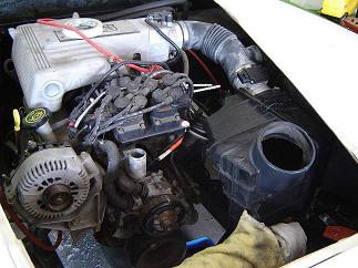

Mine is a 97 built G-force that has seen two previous owners but never been registered. I have been fortunate enough to be classed as a late 2004 classified ICV ie I get to use an AU series motor - no dark side of the force for me!!. In this case a 220kW Tickford with 5 speed so she should burble along.

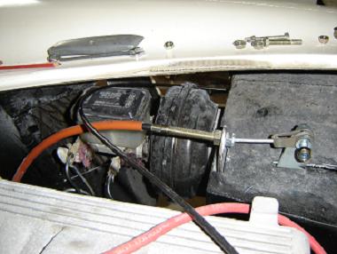

Have fitted brake and mechanical clutch systems see pic below
Needed to make an extension to clutch pedal to pull cable as the kit was set up for hydraulics, but the motor/box arrangement was mechanical as original. But am finding I have a mighty long throw, so on advice am currently going to test for clutch release and set a stop on the pedal. Can anybody provide any further advise on this issue?

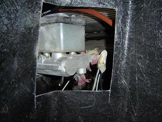

Also had to cut out a section of the rear of front wheel arch to fit brake booster and master as shown below! This had been forecast by a fellow building his second G-Force near me. He isn't a club member and I will have to work on this.
Test fitted the airbox that came with the engine and it's way too big. Have been lent a GM airbox, thanks Martin, but wonder if the smaller size will affect the engine particularly related to emissions management. Can anyone comment on this, including other options I might have in this issue?

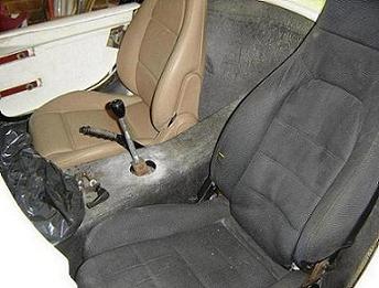

Have also been searching for ages for MX5 seats, and have two shown in the car. The black cloth seat has been shrunk and fits the GF well, the leather tan seat is full size but doesn't fit as well as expected. Here in steps the Boss and says I want them leather seats, so its cut and shut time with a visit to the trimmers.
The black seat was lent by a fellow building clubmans and who has a similar pair of full sized seats available - see my post on mx5 seats. The black seat hugs much like a race seat without the large wings even though the owner very roughly did the cut exercise. When I am finished the tan seats will need to be measured to know they are smaller!!

had to do the same chop for my brake booster - they got a lot easier after that one - now the body is like swiss cheese, I'm afraid that if I have to pull the body off again it wont hold it's shape.

Cut a hole in drivers side rear wheel well in the cockpit attempting a better fit for my mx5 seats.
Marginal gain achieved but I will do better once my seats have been shrunk some 50mm. What you have to do to get things to fit - Geez!!!!

Hi Stephen,
My car is now registered and back in my garage. As you know I have the same motor.
I am running an after market pod filter. Cold air intake, it sits behing the headlight. No problems with emmissions.
You can come over and check the fuel lines. One in, one out and the plastic charcoal canister line is right next to them. I put the canister in the boot with a vent tube popping out above the rear axle. The Au canister also has a plug for some wiring. I used the original wiring so no probs, not sure if aftermarket wiring would cover that?
We did the same, massaged every inch of the rear wall/wheel well to get the MX5 seats to fit as far back as possible. I think in the end we gained about 30mm extra length. Doesn't sound like much but it was the difference between my brother fitting and not fitting. I'm only 5'10", so fit with ease in most Cobra's, GT40's etc.
