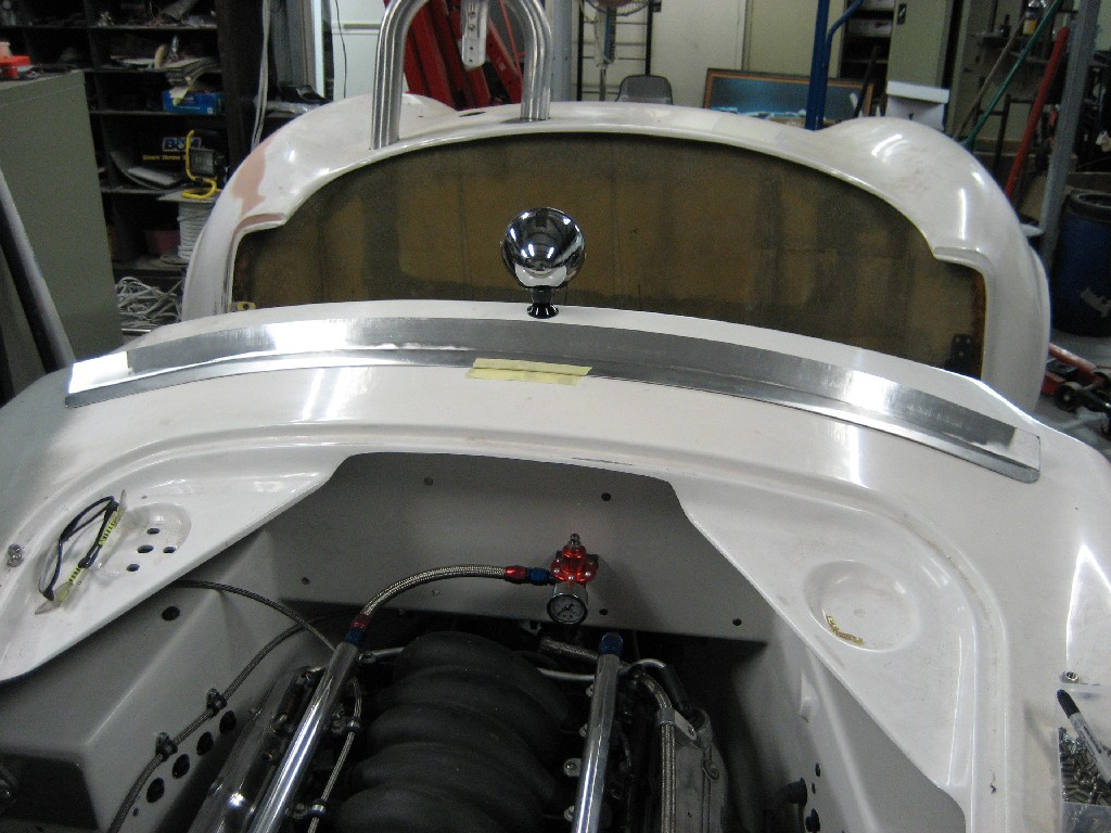

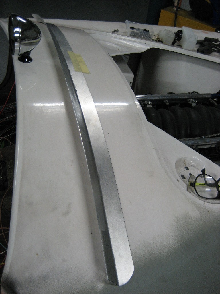

A few hours work this evening and I've got the beginings of the screen base. The shape is just rough at this stage and it'll need a bit more tweeking and finishing but you'll get the idea.
Just checking the clearance for the rear vision mirror.
I'll make a patern for the screen itself from thin masonite. I'll then take that to the plastics supplier and they can cut me some marguard sheet and polish the edges.

will you take a flat piece of marguard and shape it then attach it to your alumin. base section or do you intend to heat it and have it follow the same shape & profile?
Got a 3meter long forced convection oven here at work which would be perfect to use if you like, it can maintain set temperature to +/- 0.5oC. which allows low temp. for shaping but no distortion of the material.
Leeroy.

I think a piece of flat Marguard will work OK. The screen only curves in one plane so it shouldn't be too hard to form. I'll see how I go just curving it round and attaching it to the angle.
On the individual areo screen I reckon I'll take you up on the oven offer. I think it'll be a bit more complicated shape, potentially with the mounting flange molded in.
