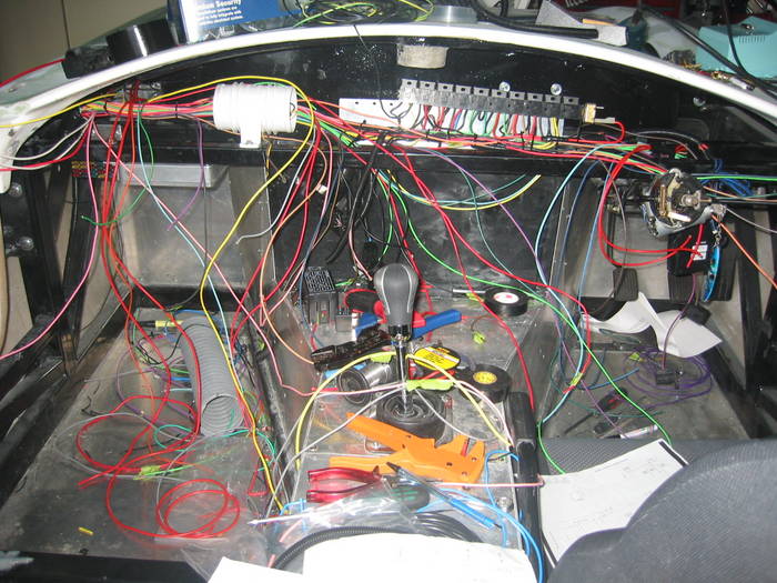

That Speedy unit looks like a nice unit.
In the Harrison I used a 3 inch marine bilge blower.
Warren
Old 09-08-2009, 05:03 AM
Merv and Sharon's Avatar
Posts: 3,482
Same as mine - from Warwick. Easy part - now all those wires ..... that brings back some sleepless nights!
